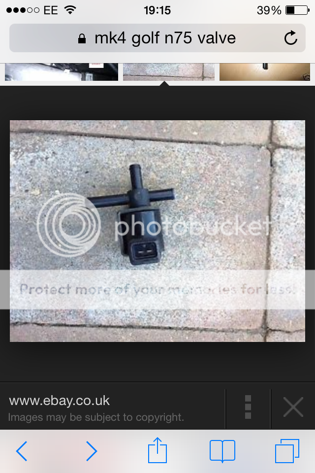

Thats ya n75 valve aka boost solinoid its located on the turbo intake tip on my phone at the min will sort a pic out and it will be slower if thats not working

« Reply #2 on: 30 March 2014, 19:21 »
this is a n75valve make sure when u replace yours you get same letter on if you check you will see on the part what letter it is

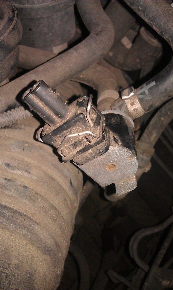

Cheers mate i can see were it is now lol but im guessing it supposed to have some wiring going to it in my case its not  :huh:  it has a plug connected but no wires

« Reply #5 on: 30 March 2014, 19:50 »
Will see if my mate can send a pic of it to me now as its parked up his

« Reply #8 on: 30 March 2014, 20:15 »
hope the link works  :smiley: but this is how mine looks (if im looking at the right part that is)

« Reply #9 on: 30 March 2014, 20:21 »
Thats the correct part and looks like you'll need to replace the two wires and trace where they have been snapped off into the loom and go from there.
