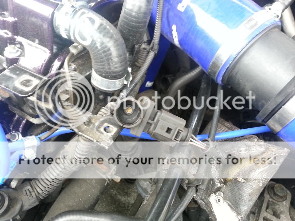

I took the fuse out and its ok. So i found only 1 switch on the gearbox, but its not at the front but behind the box by the turbo. Its a 3pin switch. So i bridged them from the blue/grey to the brown/grey, ignition was on i put it into reverse and no lights so i bridged from blue/brown to black/grey it arked so i knew i poped the fuse. Checked it and it defo did pop. I will check the bulbs again and see if they are blown. :angry:

This is the switch. I cant seem to find one on ebay with 3 wires only 2 wires
