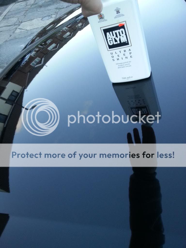

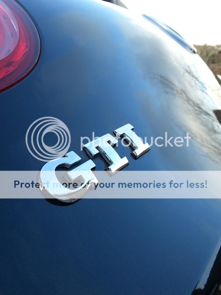

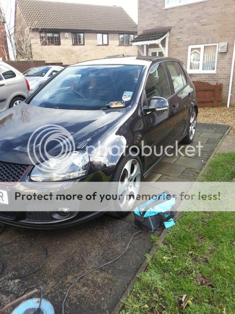

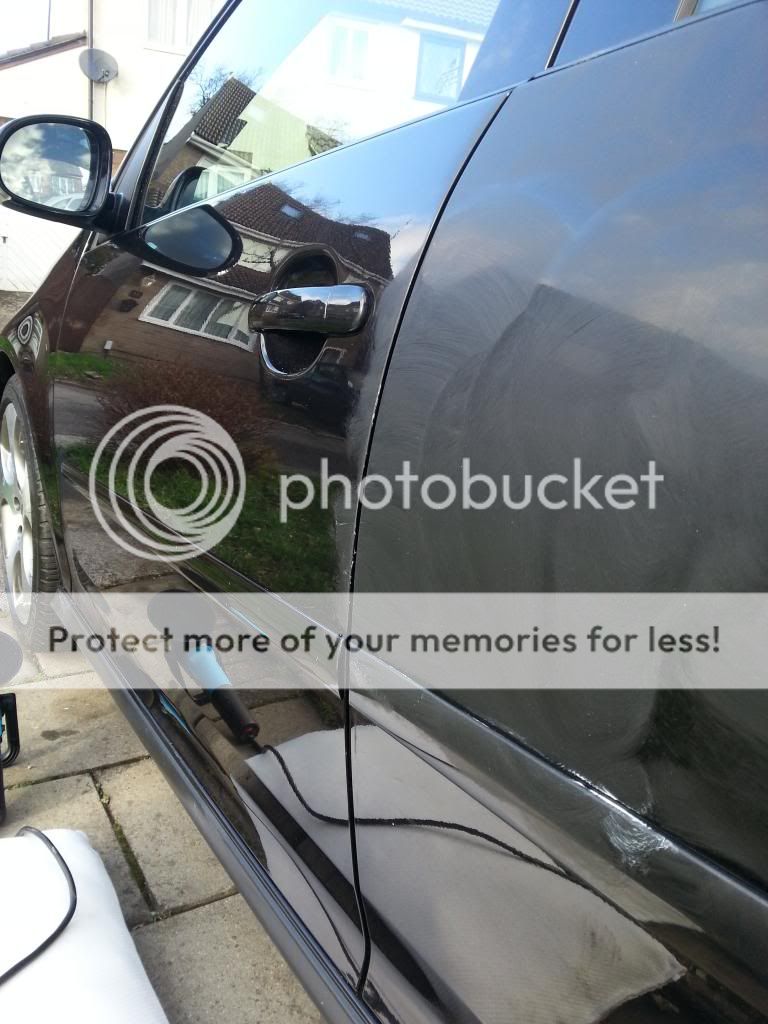

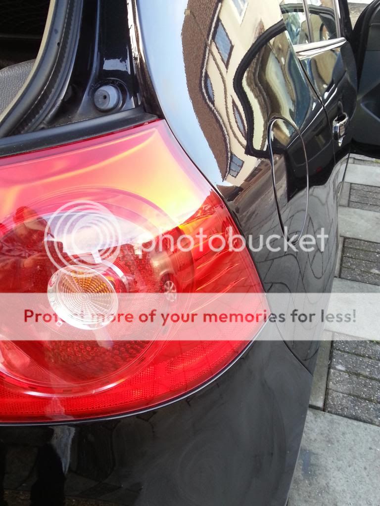

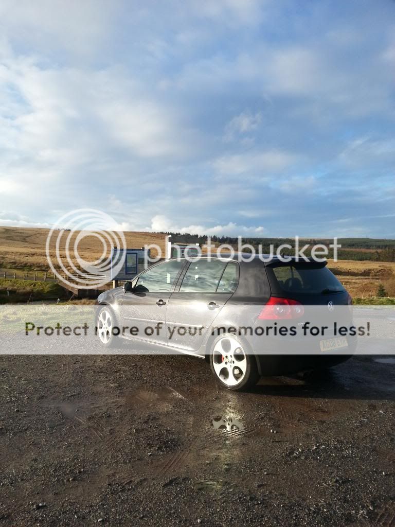

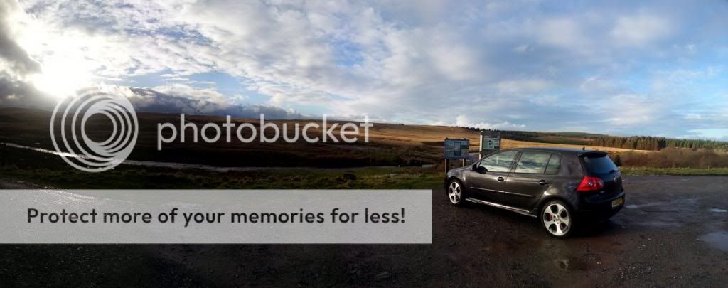

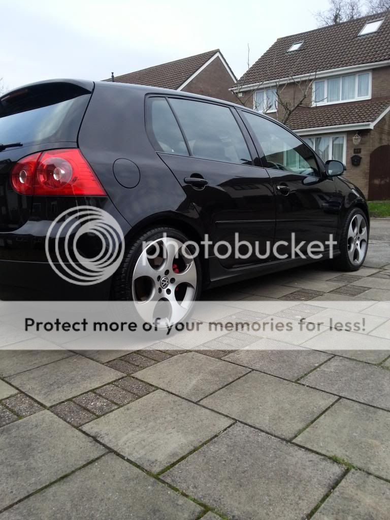

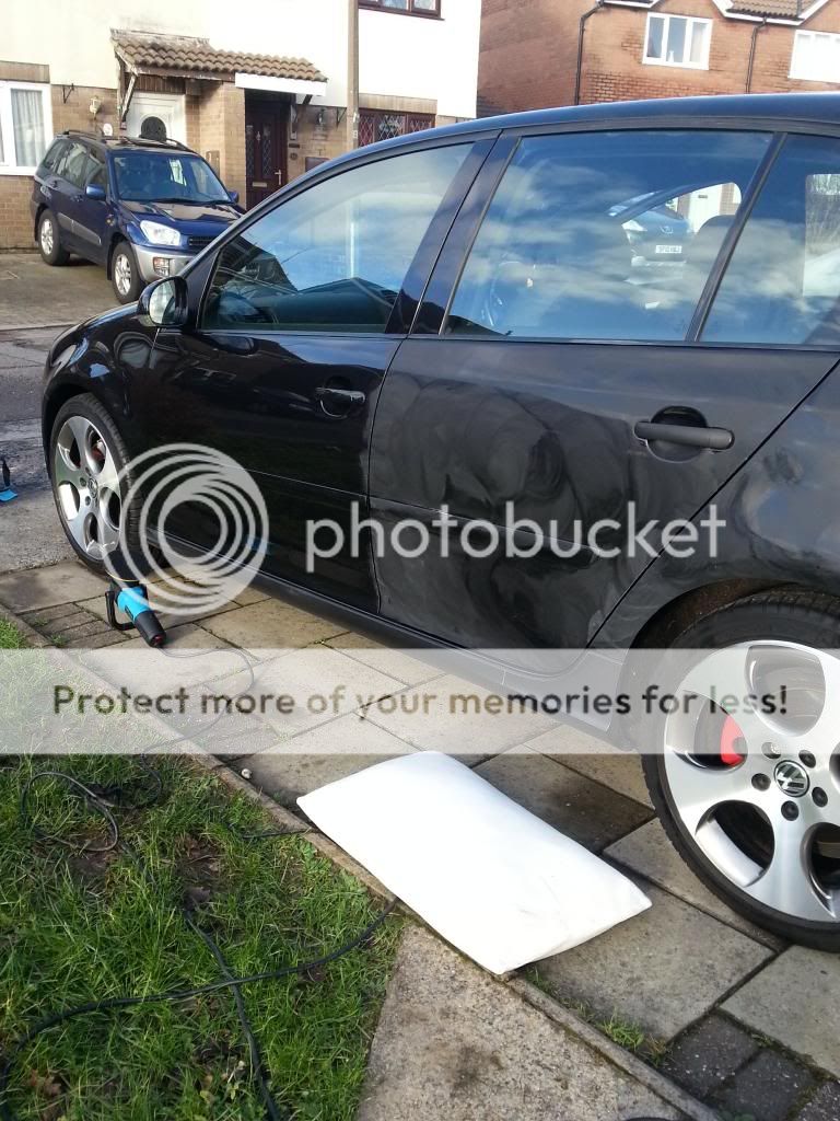

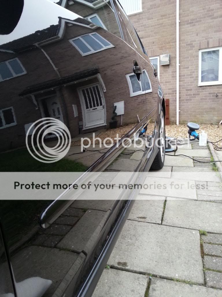

Hi All,
I'm new to the Gti Community and enjoying it! I purchased my Golf which is a 2008 GTi 2.0T Fsi a few weeks ago, I travelled over 1500miles over a month looking at a few Golfs and eventually found this, It has a full service history, 80k miles and I have just had a full service and inspection on the car today which came back with a clean bill of health!
I really enjoy driving the car its so much fun! Anyway the car wasn't nowhere near up to my standard of cleanliness when I purchased it so I took two days off last week and put in 14 hours of detailing so thought I would show you all a bit of my work so far....
Next Up - Interior and Engine detail - Really pleased with the car so far ....Thanks for looking!
Steve :smiley:

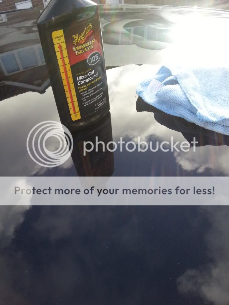

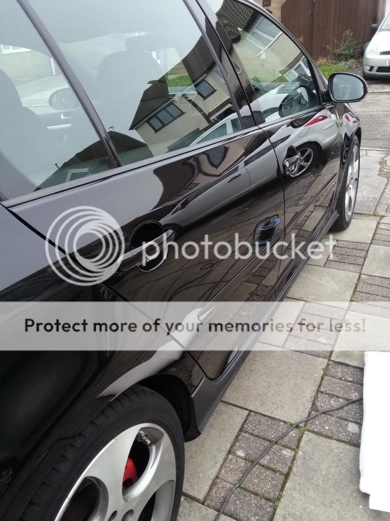

I should mention that the car was Snowfoamed first, clayed, Cut with Meguiars Mirror Glaze, Auto Glym Deep Shine applied then a final coat of Auto Glym HD Wax.....Just incase you were wondering what I had done with my 14 Hours over two days!!!

Cracking job Steve nice car

Did you need to refine the finish at all after the 105? I've used 205 quite a bit to great effect but only used 105 on a couple of spots on occasion but it needed a little finishing afterwards due to how abrasive it is.

Hi Guys,
Thanks for the replies, Yes 105 can be quite harsh but I done the whole car which has lifted all the swirl marks and light scratches, I didnt mention I then used 205 after the 105 then the Auto Glym! My previous car was a Black BMW and I used this method and had outstanding results!
The car is currently sat on the drive and the paintwork looks so deep with a great gloss finish as though the car is wet! I'm very happy with how it's looking...but I will be putting a lot more hours in- If i'm home early tomorrow all the wheels are coming off for a clean!
