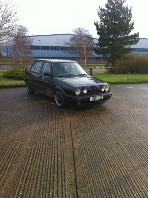

I drove to work this morning and it was all good. When I left it was revving itself to 3k with the clutch in and when in neutral, and driving itself along in the lower gears :P Would a litte wheelspin out the car park have upset something? surely not....
Any ideas?
Having driven a big daily for 3/4 years im not too sure what I should be looking at. The mechanism on top of the inlet appears to working ok.
