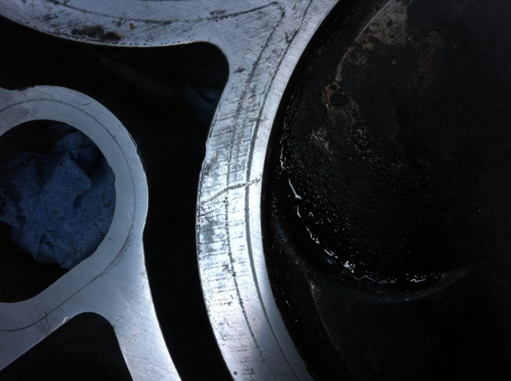

Right. I used a scraper which I sharpened and some 1000 grit wet and dry with plenty of wd40. It came up a treat so thanks for that. The bad news however is that i found this:
Funnily enough this is on cylinder 1, which isn't one of the cylinders that was leaking.
Reckon it'll be ok to go ahead and stick the new gasket on anyway? I really can't be arsed to take the block off and skim that too...

Not ideal tbh, as its across the sealing ring around the cylinder.
It should be ok, I guess you will just have to risk it?
