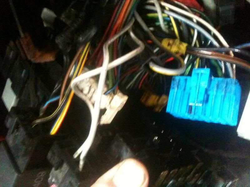

« Reply #11 on: 20 January 2014, 21:42 »
Managed to get the box of the bracket and have a look behind, it's a bit of a mess as there's been bodging action before, some old wiring can be removed but it'll wait till I get a go in daylight, almost every fuse has corrosion at the terminals, I can see a source of water ingress but will be surprised if its the only one, needs to all come out so I can clean up the area and seal up the leaking bilkhead!

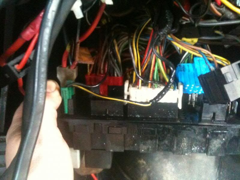

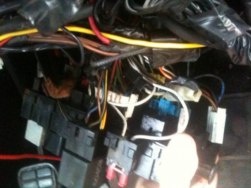

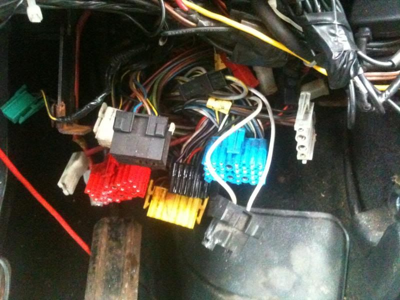

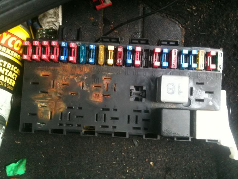

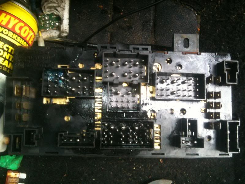

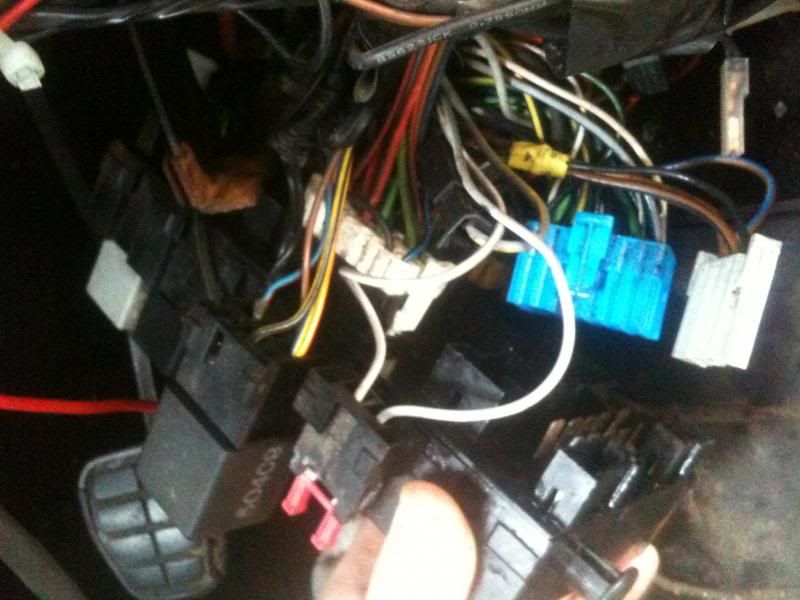

Offline benday007
  • Posts: 125
Re: Relays/Fusebox Problem

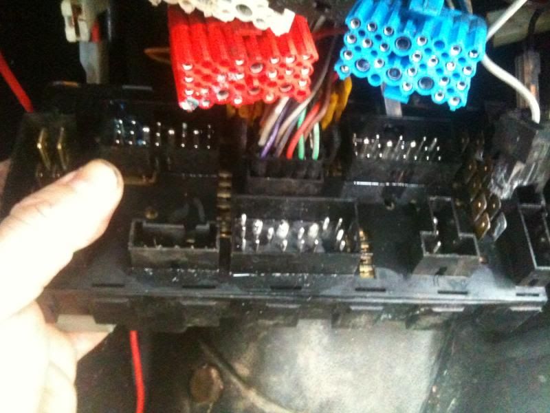

« Reply #18 on: 28 January 2014, 21:21 »
Well....Photo's of my CE 1 fusebox being removed plus the rusty article ready for the bin
