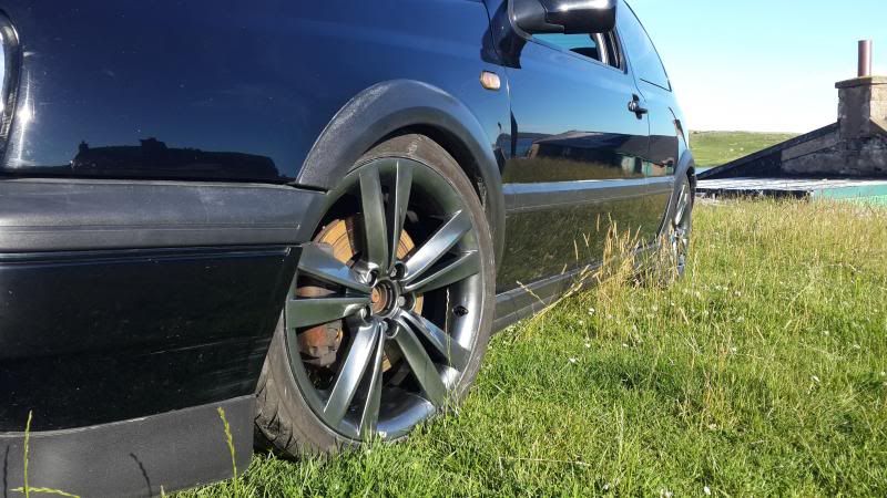

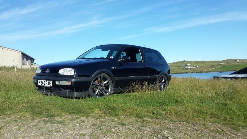

« Reply #6 on: 24 December 2013, 17:35 »
depends how much its lowered if at all this is my car with 17's with 205/40/17 and its pretty low and the wheels dont catch  :cool:
