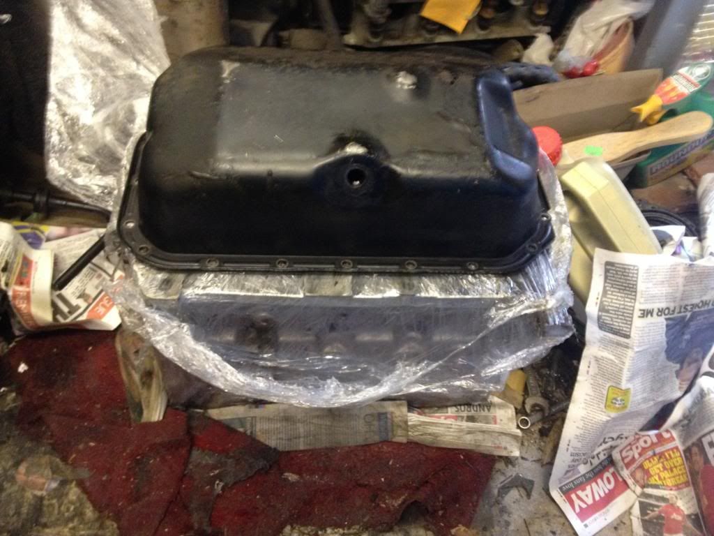

I do have a plan B!
That Diesel engine I took the crank out of has a sump! :grin: :evil:
Said sump has a small hold so gonna check if this magnetic plug fits that sump.
If so will fit that as an interim as I will be doing at least 3 oil changes.
Then after the third I can fit the very nice aquablasted sump (courtesy of JNL Racing) and by that time have found and obtained the correct sump plug!

« Reply #15 on: 24 December 2013, 11:08 »
Plan B works!
Its also a steel sump.

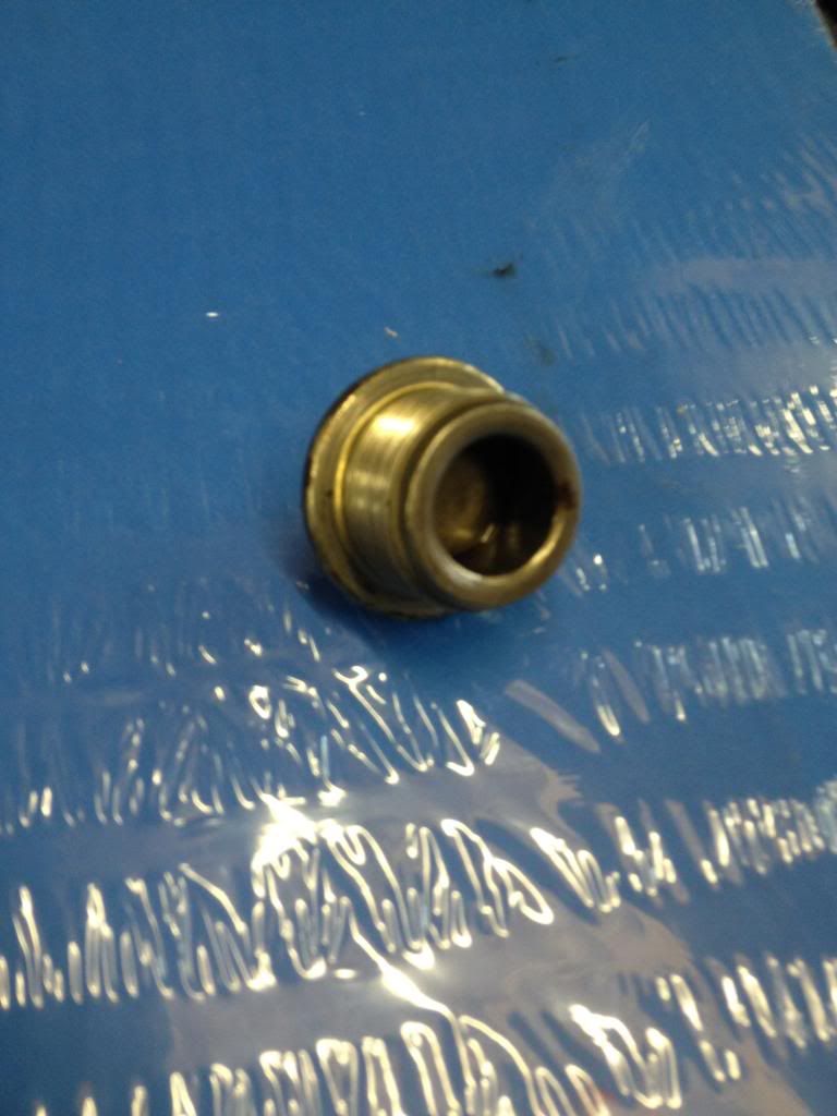

« Reply #16 on: 24 December 2013, 11:10 »
Couple of pics of the sump pug for the outher cast ally sump

« Reply #17 on: 26 December 2013, 15:27 »
Measured that sump plug today and its definitely 26mm so that makes it a VR6 sump and plug!
Well thats what a lot of websites say is the size for a VR6 sump plug and that is what I have today ordered from the magneticoilplugs website along with a set of 6 magnets.

« Reply #18 on: 29 December 2013, 16:01 »
Len the abf uses a m26 and and all other mk3's use the normal m14 (even the vr6 so the listings say, I will know soon when I service the VR)
I did some digging and the brands list m14 as std fitment but I asked my german engine people who said m26 (I am going to keep a plug or two in stock (non magnetic))

« Reply #19 on: 30 December 2013, 20:48 »
have ordered an M26 one plus some filter magnets so that should sort it!
