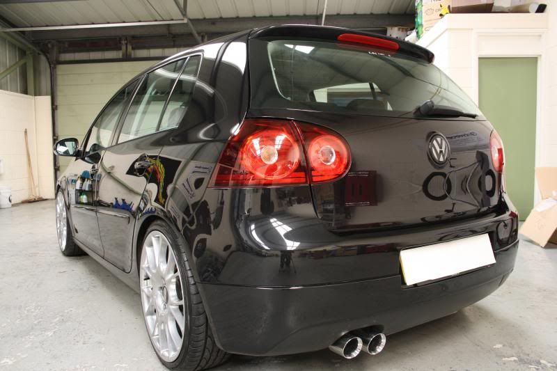

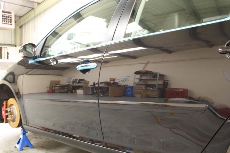

The wheels were being removed after the wash and decontamination process to be powder coated so they were not cleaned

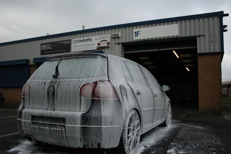

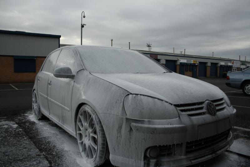

I went round the car using APC in a foaming head bottle cleaning the fuel filler area and various gaps and grills. The snowfoam was then blasted off with the pressure washer, and then the car was given another coat of the same mix snowfoam and the car was washed using the 2 bucket method with grit guards in both buckets and a Carpro lambswool wash mitt.
The car was then rinsed off using an open ended hose and I then went round the car with Tardis which was left to go to work before being wiped down with microfibre clothes. The car was then given a coat of Ironx again left to do its stuff before the car was washed down using the pressure washer.

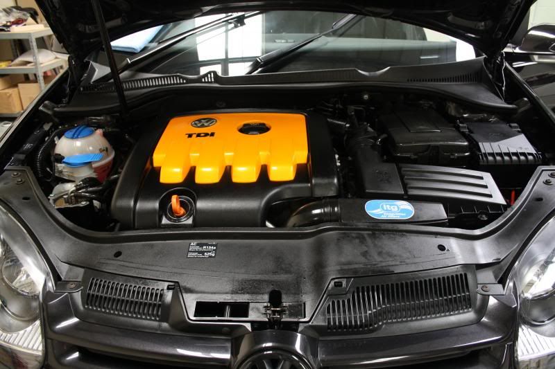

Engine bay was cleaned with Megs APC a various detailing brushes before being rinsed with the pressure washer
The car was clayed using citrus bling and water mix (10 to 1) and a Bilt hamber soft clay bar which helped to pull more contaminates from the paint work it was then rewashed using the same method and dried using the woolly mammoth.
Snow Foaming

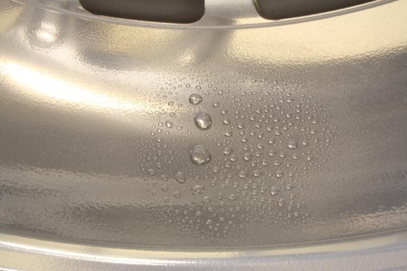

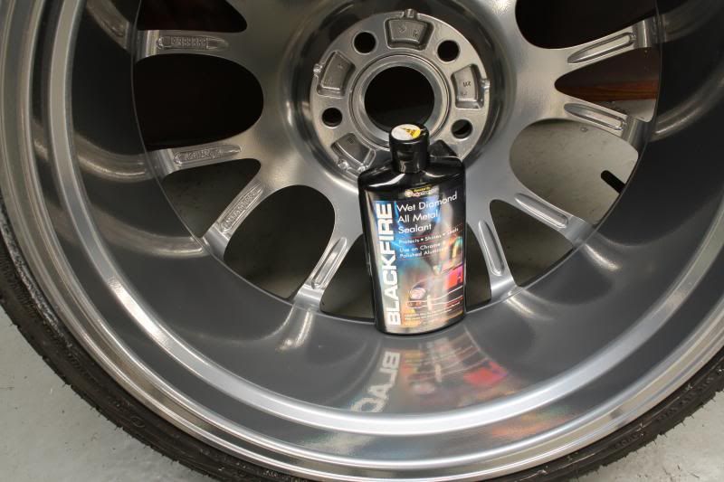

Wheels sealed Once Back From Powder Coating

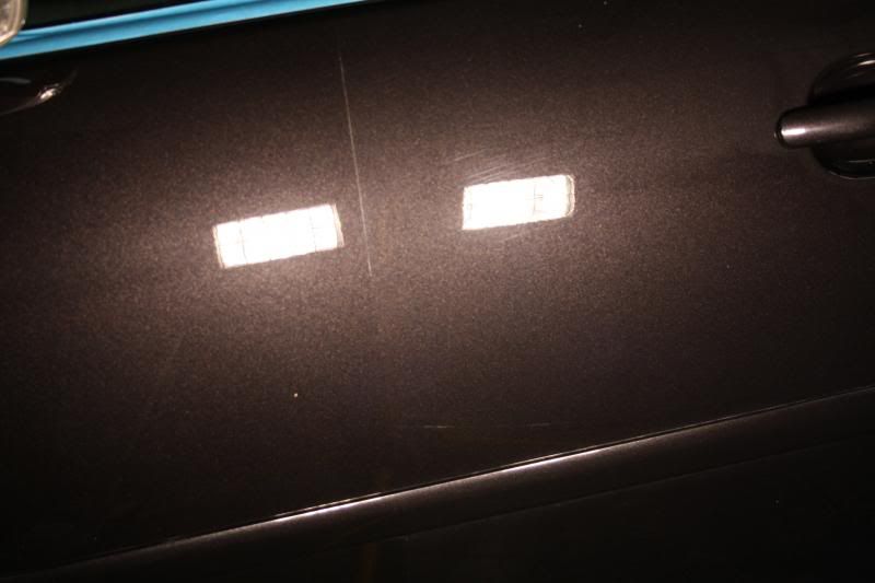

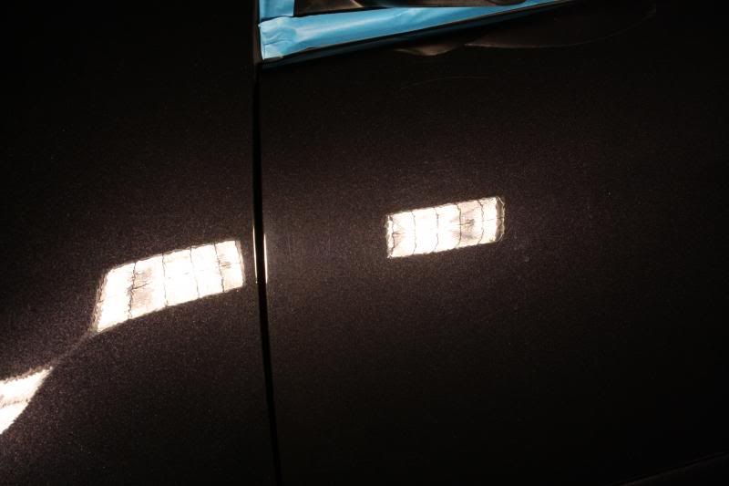

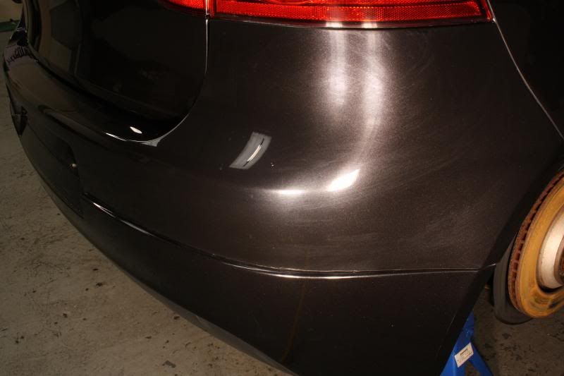

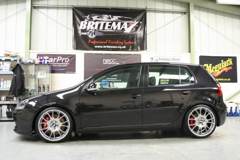

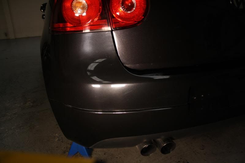

Car Before Start

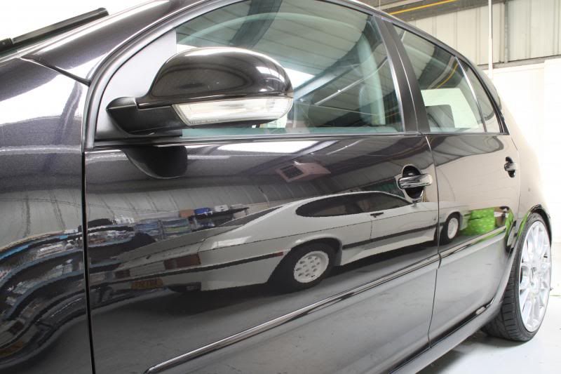

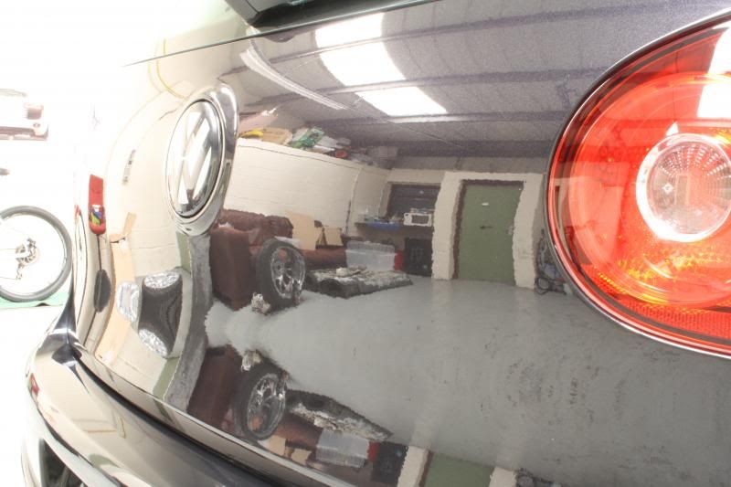

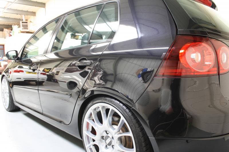

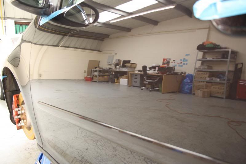

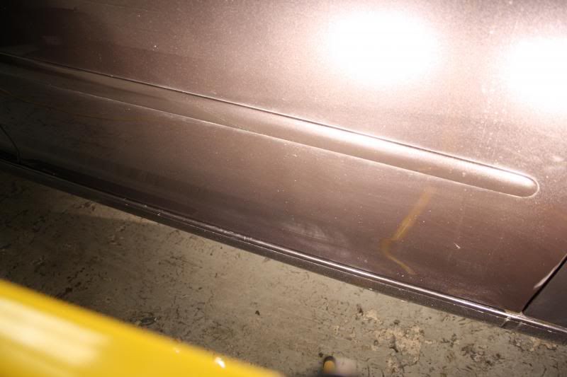

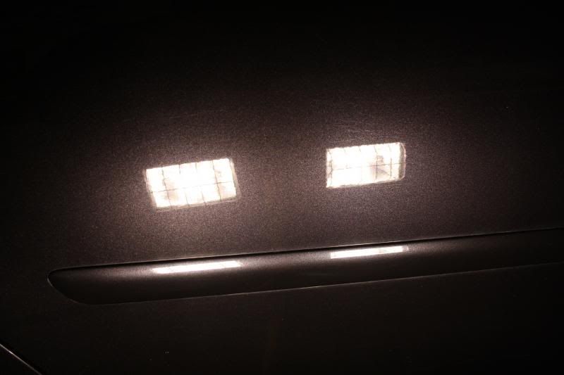

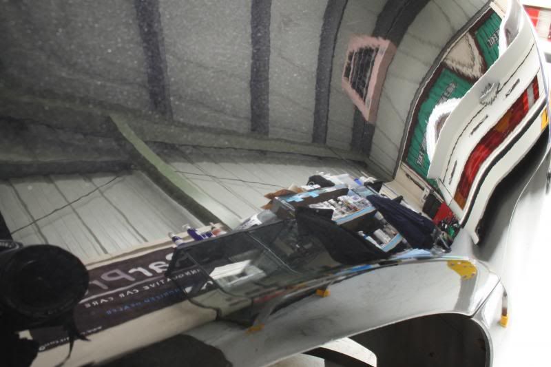

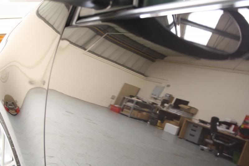

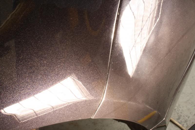

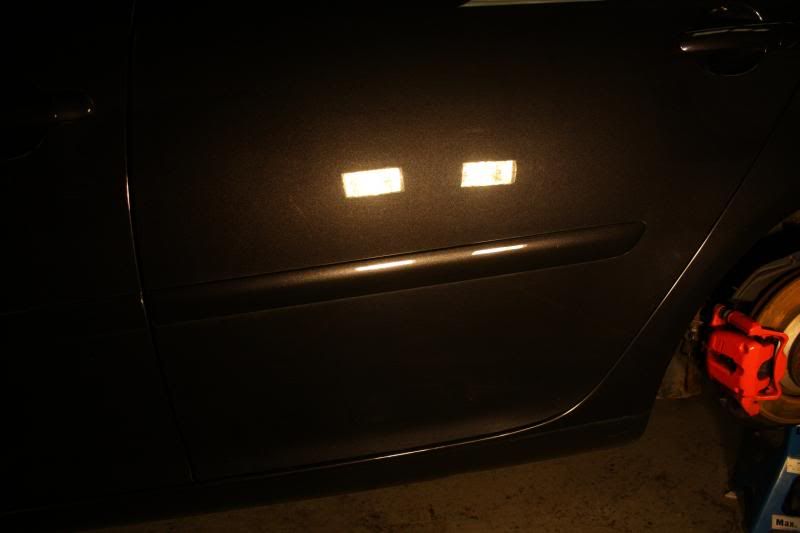

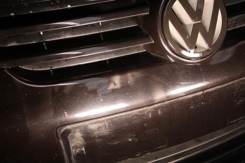

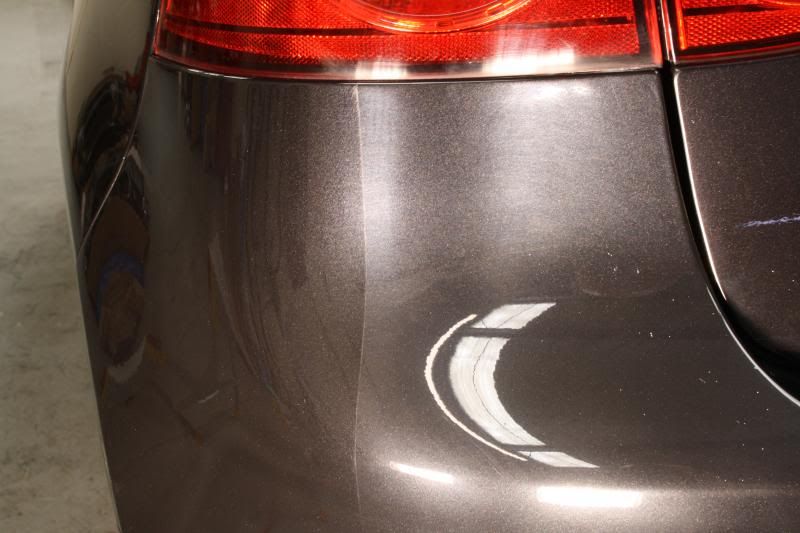

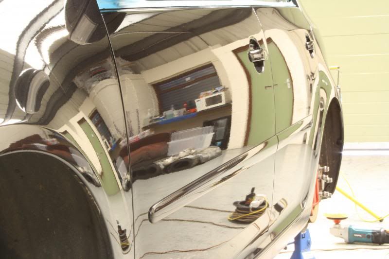

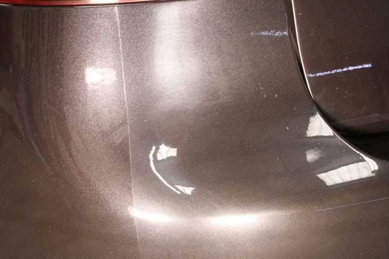

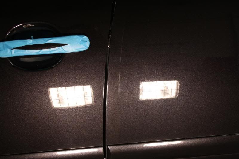

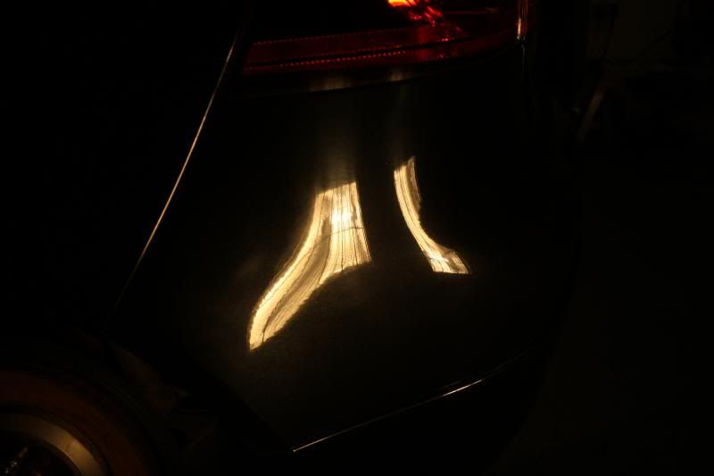

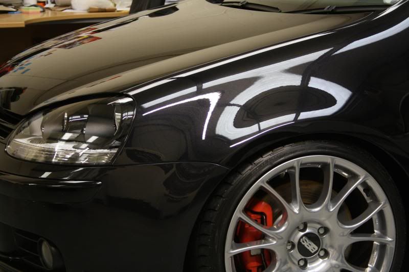

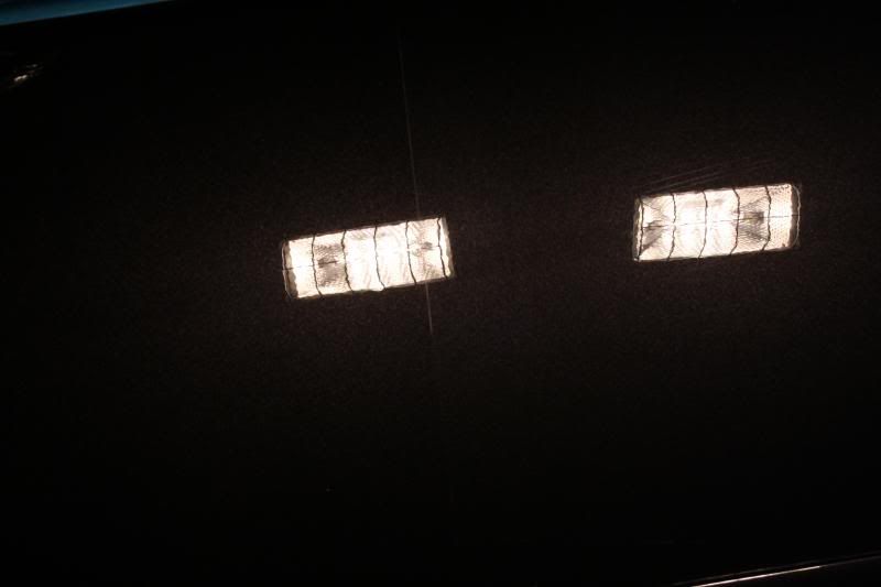

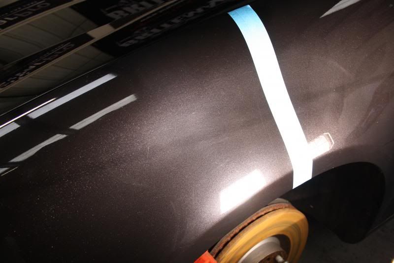

I then taped the car up and went round with various yellow 3m pads and Megs polish, each panel was given a wipe down with Carpro eraser after polishing to check finish and remove any polishing oils.
Flake Starting To Pop
Engine Bay Dressed

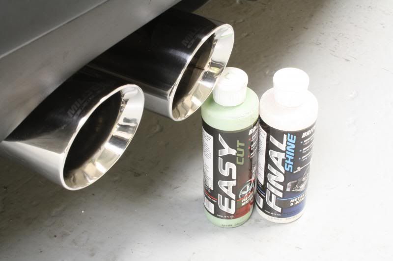

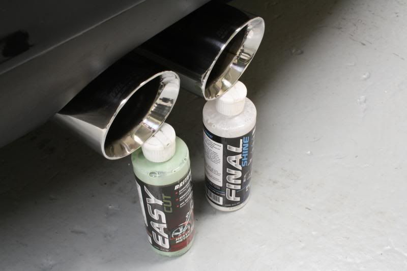

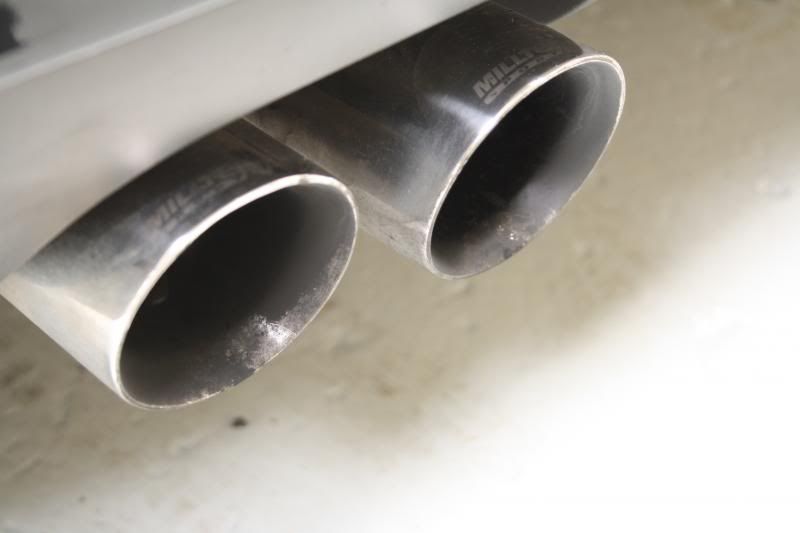

Exhaust Polished

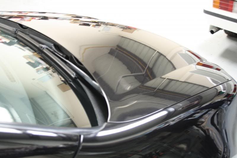

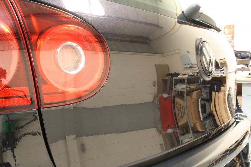

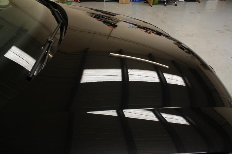

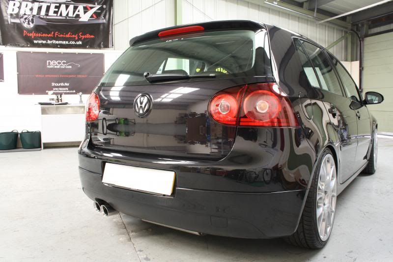

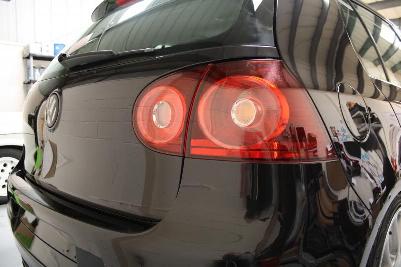

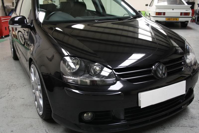

The car was given 2 coats of Blackfiire Midnight Sun wax leaving wax t approx 60min between each coat again buffed using Uber buffing towels
The plastic trim was dressed using CarPro Perl which is a cracking product which a little goes a long way and gives a stunning finish.
After this I cleaned the glass and gave them all 2 coats of glass sealant

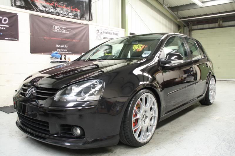

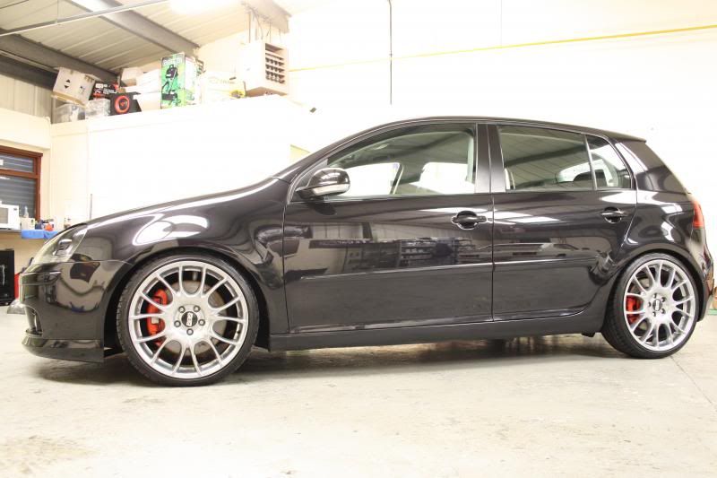

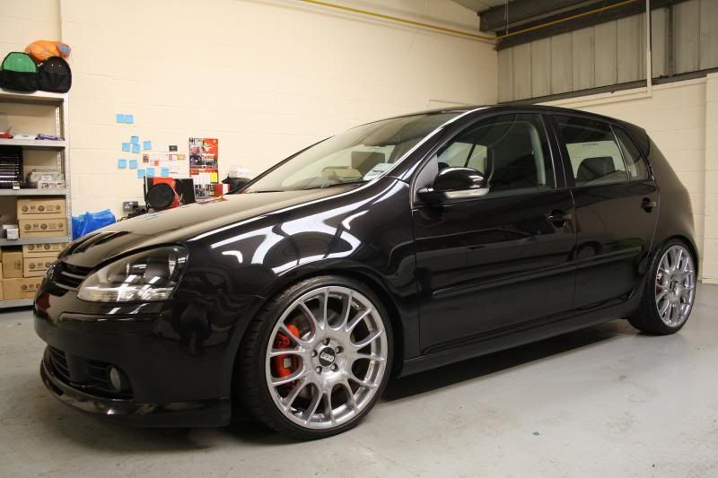

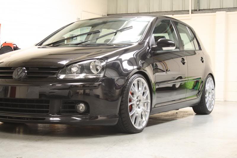

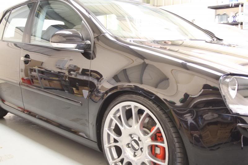

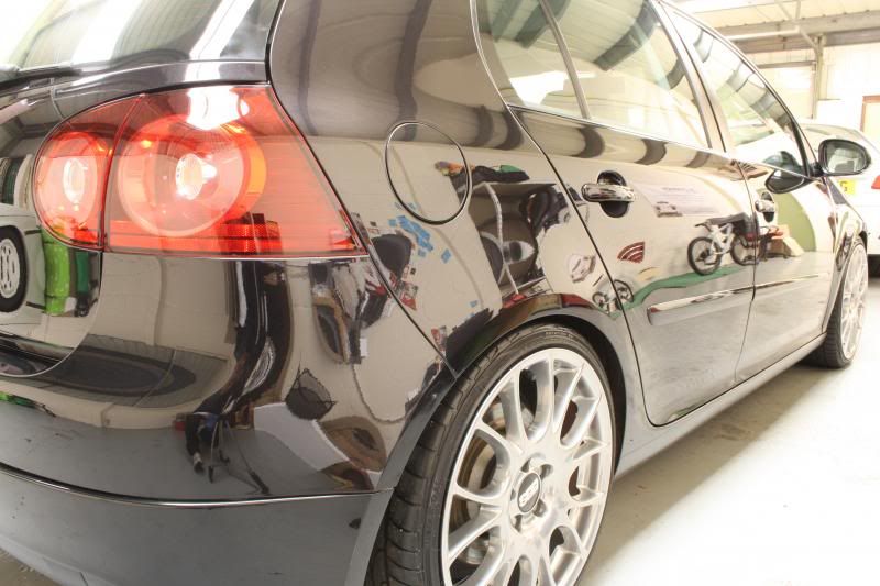

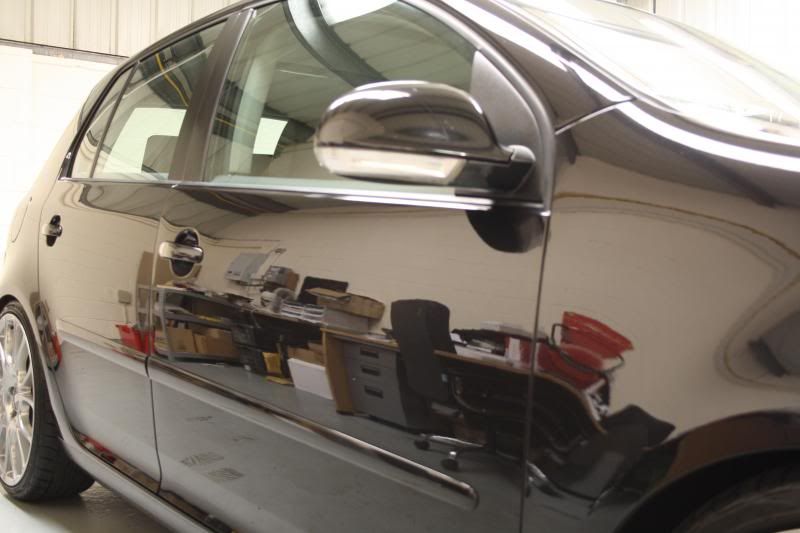

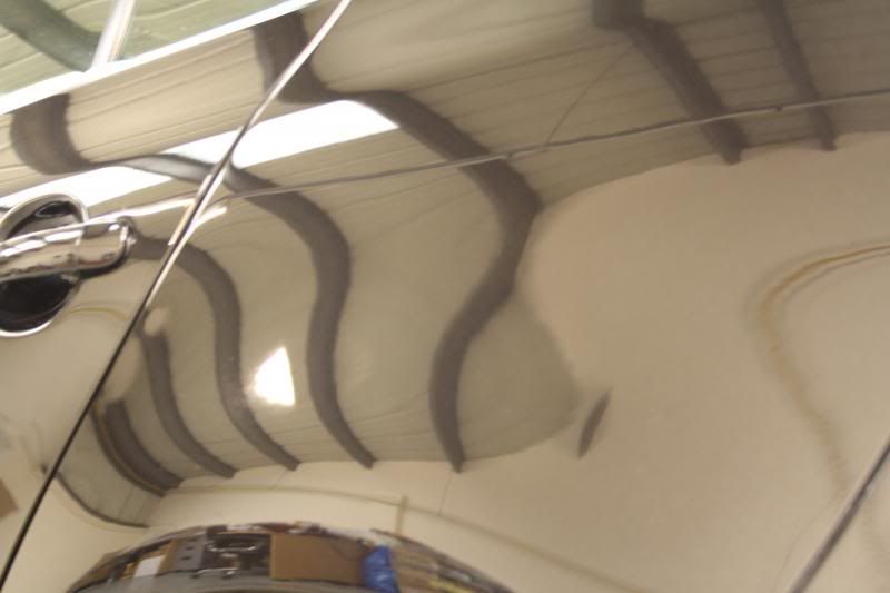

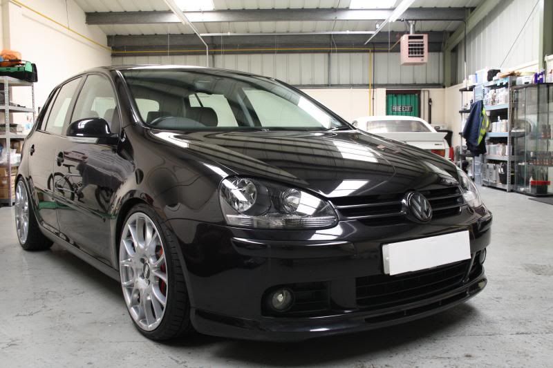

Finished shots
