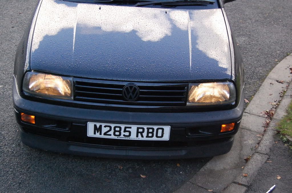

Basicaly i saw a Mk2 golf in town last night and it has its indicators on all the time so using them as sidelights but when he indicated right the unit still flashed so how does one go about this on a mk3 ?
it quite like the look , ive done a quick google but all the cars ive seen have all been US spec already so not much help or bm's where all the lights are in one lamp anyways not seperate like the mk3
anyone got some advise ?
