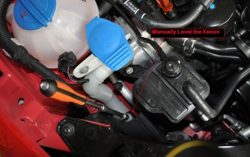

I have the osram NB in my car and whilst good I feel I've shafted myself somewhat that since lowering my car I haven't adjusted the angle of my headlights so the actually distance the light is going has been reduced.
Is it even possible to adjust the angle of halogens other than the switch inside.
10 Plate, Silver DSG,  APR Stage 2, APR TBE, Carbonio Intake 1 + 2, Bilstien B8 + VWR Springs, Eibach Front & Rear Roll Bars Powerflex Bushings, TyrolSport Subframe Deadset Collars, Whiteline Endlinks Front & Rear, Neuspeed TOP and Intercooler Pipe, R8 Coilpacks,
Offline mustard
  • Posts: 335
  • Mk7 R
Re: Headlight bulb upgrade
« Reply #8 on: 20 November 2013, 08:13 »
There are two plastic adjusters for the headlights, one for the height, the other for left and right. See picture (borrowed from an Australian site) although it says Xenon, the adjusters are the same.
The left/right is accessible through a gap in the front wing, the height adjustable is easier.
Takes an Allen Key, not sure of the size, around 6mm.
