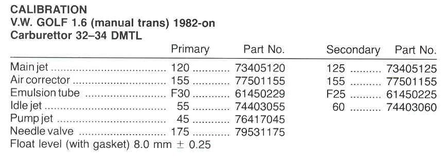

Do you know which side is the Primary jet and which the secondary? or is it simply the side that you put the differing jets / idles on as per table below:
