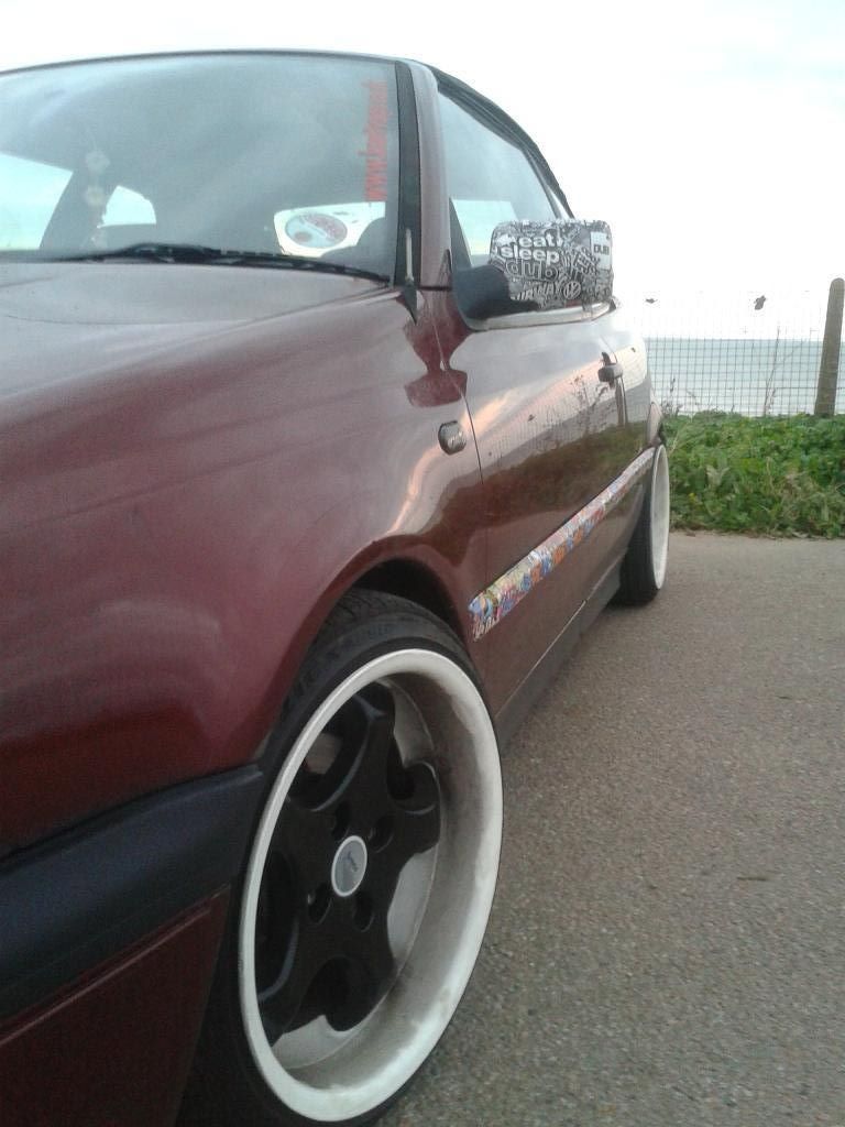

hi all,
i currently have 16" 9J wheels on my mk3 golf. The tyres are 215/35/16 stretched.
i really want a bit more of a thicker tyre on them, its not going to be fun driving around in the winter with these thin tyres on and its not5 fun if you roll over a stone in the road or anything!
problem is the tyre tread is only just inside the arch so not too sure if i have any other tyre options which would work.
anyone got any ideas?

215/40's?
Or have a shifty for some cheap winter wheels that you don't give two hoots about if you kerb them in the snow.

yeah might be a better and possibly cheaper than replacing all the tyres.
stupid question possibly but if i did get 215/40s do they need to be a special type of tyre to be stretched? lol

No.

214/40's are rare (golf anni mk3, some american tat and mgf rears only I believe) so they are not cheap for good one's.
I would buy some alloys for winter and use decent tyres (get some 15's as you can get wheels and winter tyres for under £300)

actually the 215/35's seem harder to get hold of. So the 215/40s will still be able to stretch? what are the rules on stretching tyres i mean is there a maximum profile that can be stretched? can any tyre place do it?
also do you think if i went for 225/40s they would clear in the arches?

Not that rare
http://www.camskill.co.uk/m62b0s319p0/Car_Tyres_-_MPV_Tyres_-_People_Carrier_Tyres_-_16_inch_R16_inch_-_215_40_16_215_40R16
ok rare was the wrong word (I should of used uncommon size, and even more so with 215/35)...
and regarding stretch, some tyre places won't touch them so your choice of fitting shops will be more limited. I do know of a mk3 with 7" wide rims running 165's!!

Haha, my RS's are 9.5" wide with 215/35's.
Thank god I fitted them myself!
