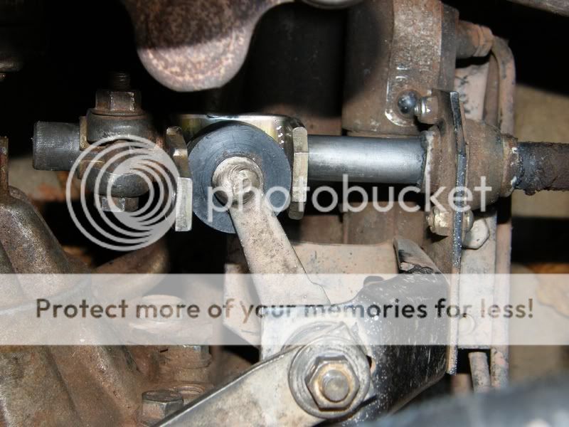

Is the selector mechanism set right and does it go into gear easy?
Sounds like the mechanism is not seated in the correct position. Loosen them two 13mm's, get someone to pull the gear stick back then forward and into the central position.
Tighten the nuts and it should be dead centre and go into every gear
