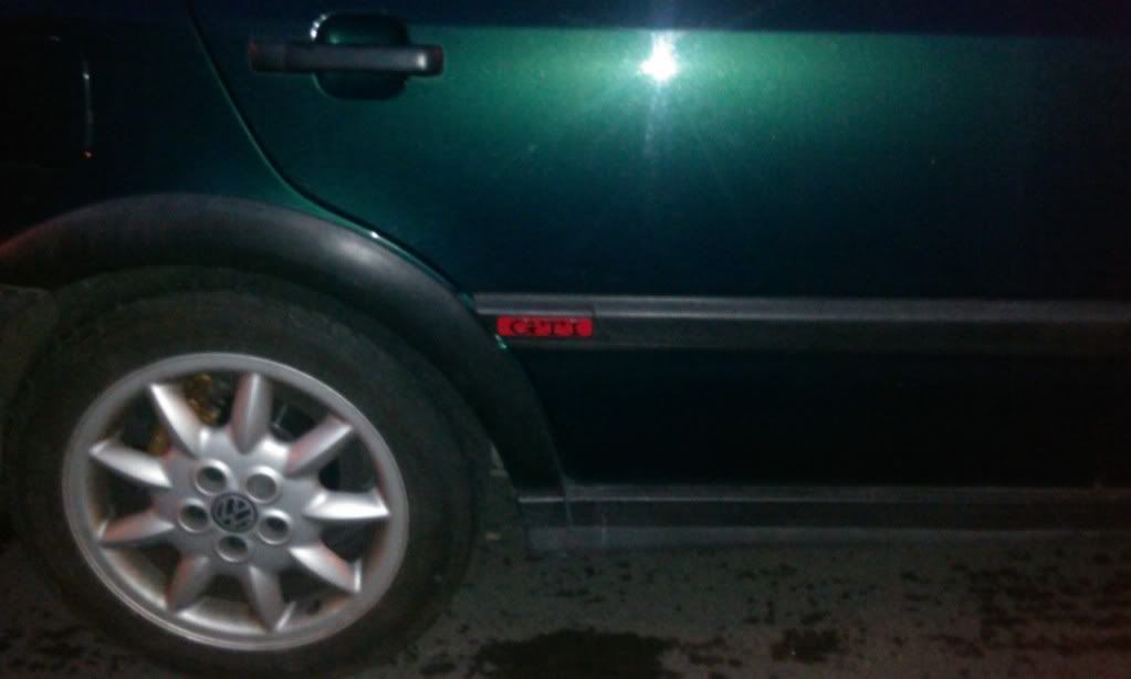

I liked the red MK2 door GTI badge way better than the MK3 badge, so i set about re-vamping mine today and heres the result

This looks really good!

That does look good! Any particular trick or just a steady hand with the paintbrush?

I had my door trim off for repainting the bottom panel, so i took the badge out scraped the silver off the gti with a Stanley blade then sprayed it with primer, then scraped the primer off the gti, then sprayed it red and scraped the red off the gti, then give it a coat of lacquer

Neat! Might have to copy that..... :smug:
