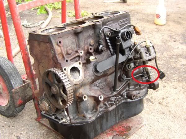

On the AGG engine the crank position sensor is located ob the engine block behind the oil filter and engine mount.
Circled in red in this pic....

Thank you so very very much!I will be able to find it now on my car....(I guess I will have to remove the oil filter to get to it)
One final question:where does the other end plug into? I may just need to clean the connecting plug first and see if that makes any difference.....might not have to take it off then...:)
