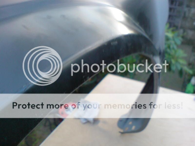

You can have your cake and eat it.
 I rolled my front arches and retained my inner plastics, removed outers too to prevent grot building and rotting them out after I replaced them.
Doddle to do, if you want pic's of mine let me know.

I got after market wings as they were cheap and didn't have rust, nor did they look like someone had rolled them with a brick. However they did take significantly longer to make fit than OEM so use your judgement. If you can get good OEM, go with them. You can make your own rolling tool from a skateboard wheel and a widow maker jack. I used the cut card technique on this occasion as it was the best option at the time.
Outside after rolling
Sealed up goodness
Primered
I'll post up a pic' of the finished article when I get my car back at weekend. But the plastic arch locates in normal holes with 10mm speed fixings and doesn't flap about.
HTH's

You can make your own roller from the widow maker jack, a wheel spacer and a skateboard wheel. Mine worked well.
Google it.
As for reattaching arches some automotive sealant will do the job. Sikaflex, tigerseal etc
Make sure your arches aren't rusty or you'll end up wrecking them. Also cleaned thoroughly then sealed as otherwise you'll make a dirt and water trap that'll rot out.
