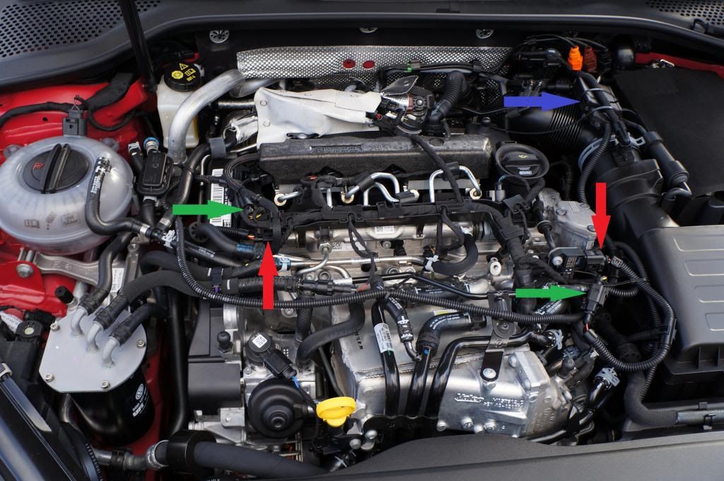

Photos as promised.
Engine bay post fitting, with system fitted.
System fitted, cowling off. Red arrows are system plug-ins and green ones are original VW plugs, plugged into the wiring harness (left arrows from common rail sensor, right ones from the air intake sensor). Blue arrow is the box itself:-

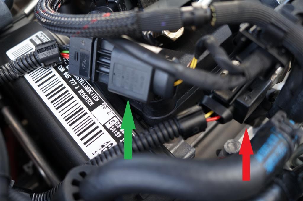

Common rail sensors up close, same arrow colour scheme:-

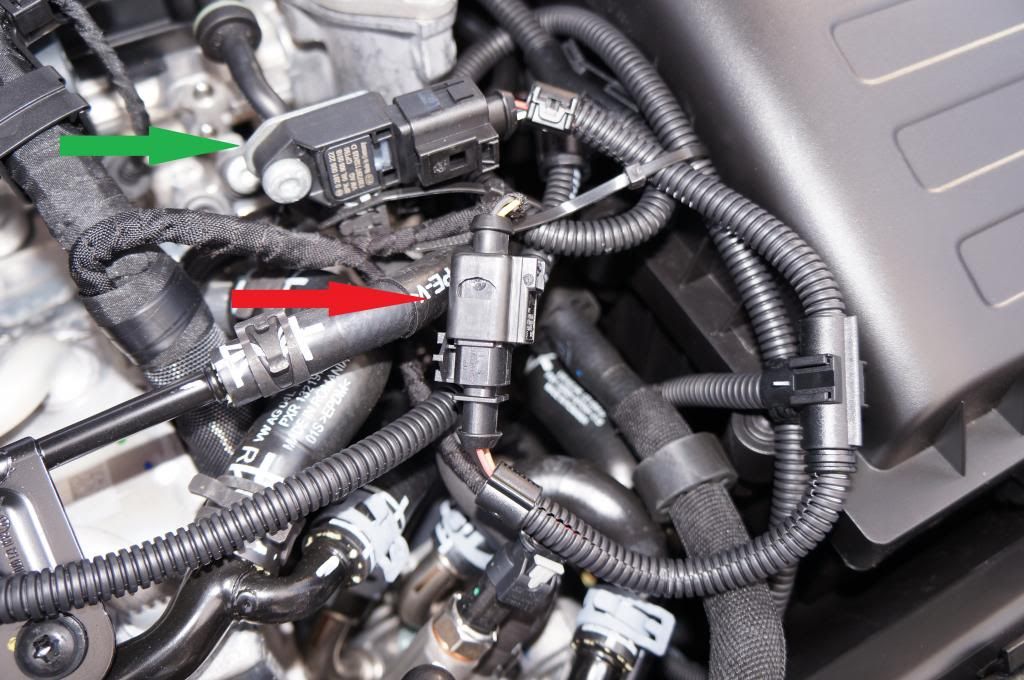

Air intake sensors up close:-

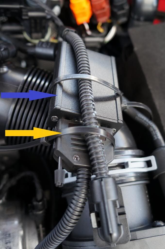

The box up close (box is blue), with wiring harness (yellow arrow):-
