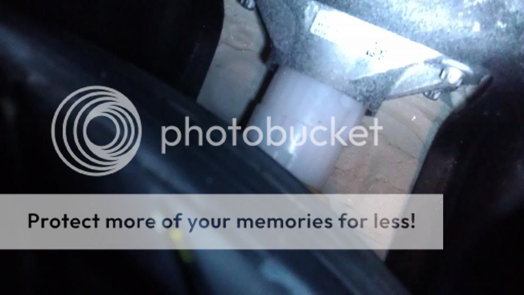

Apparently its really easy to see them even if you don't jack it up.  The only picture I've seen of them still on the car is from that first BMW thread.  You could also check the ride height by measuring the gap from tyre to arch on each corner.  If its 10mm extra on the suspect corner then thats evidence its not like its supposed to be!
Here is the image from that thread:
Probably similar on all makes of cars.  Thinking about it I'm going to check mine just in case! :grin:
