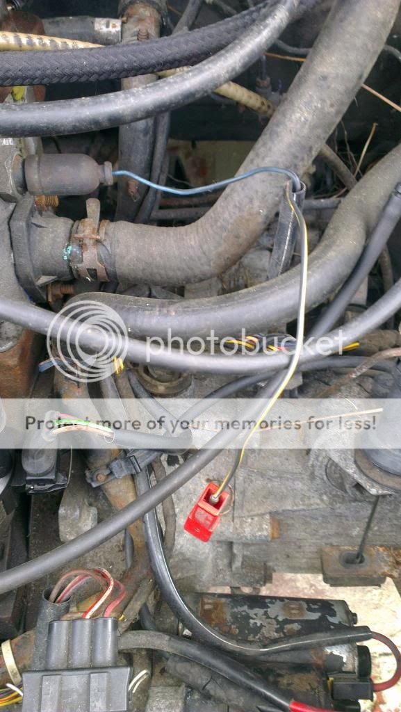

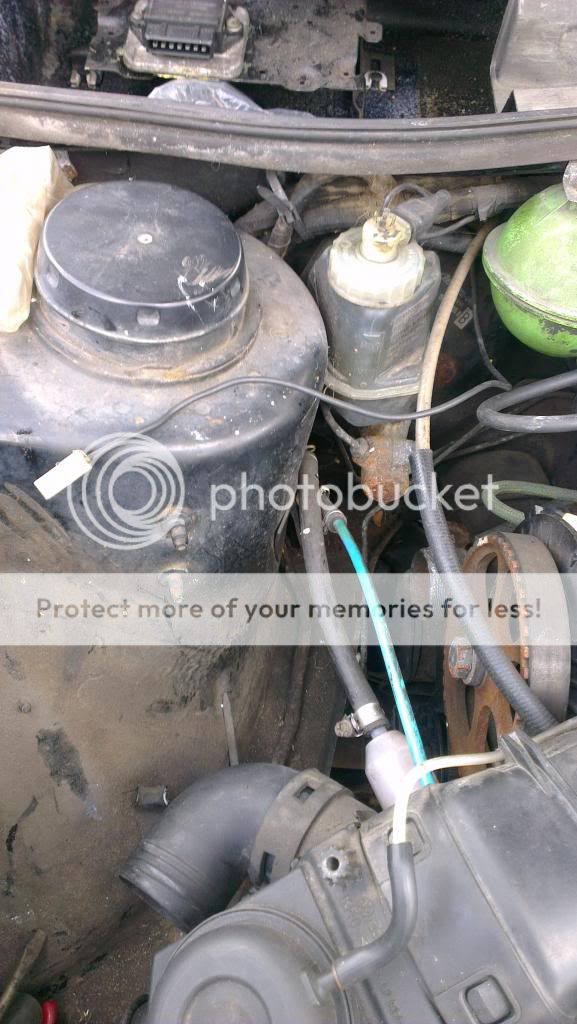

Hey guys anyone know where these two wires go? just found them flying around the engine bay
the car is a 1.6 Driver 1991 engine code: EZ 8 valve
any help would be appreciated
Thank you
Yellow one with the black strip
http://i695.photobucket.com/albums/vv313/patel5557600/Golf%20Mk2/IMAG0484_zps7504dd08.jpg
think this one is something to do with the radiator fan
http://i695.photobucket.com/albums/vv313/patel5557600/Golf%20Mk2/IMAG0481_zps6d4fd154.jpg

has your engine had a carb replacement? if so the wires could be related to the old carb. I think the black one might go to the inlet manifold air heater. spade should be underneath. oh and your ignition module doesn't seem to be plugged in.

No, the carb is the original. Will defiantly have another look around. Haha there is another ignition module that is plugged in, just cant see it in the pic. That one is faulty and needs to be removed.
Thanks for the heads up though
