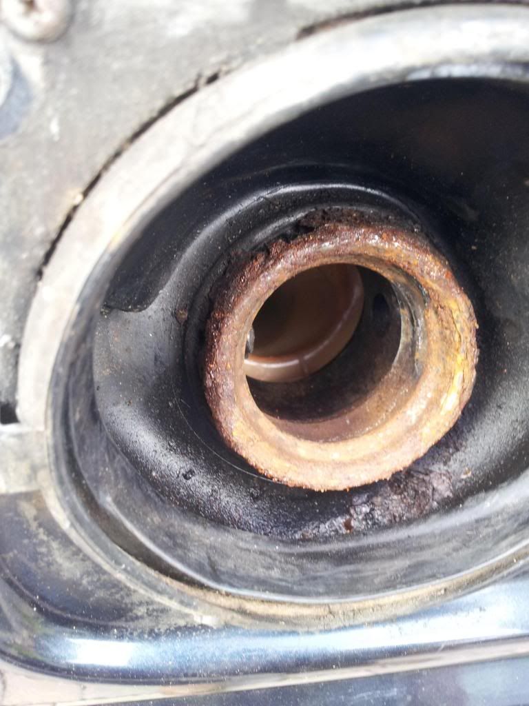

Can you get the filler neck part on its own or is a case of changing the whole tank?

What car?
As the filler neck on a Mk3 is plastic!

hi Len,
Its a 1991 mk2 golf gti.

tanks all plastic. except for that rusty bit in pic which is only half inch long.

whats the best way to sort this out?
are replacements available? or would it be a case of cutting one out of a scrapper?

you could just fit a mk3 tank and pump. im sure you could find one that aint so rusty there as they are newer. and then you can also do away with under car fuel pump. very easy conversion to do.
