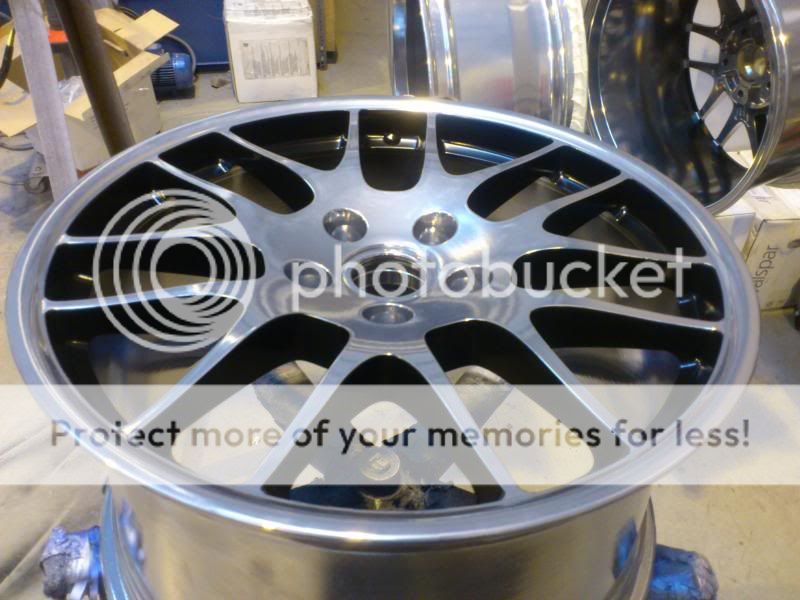

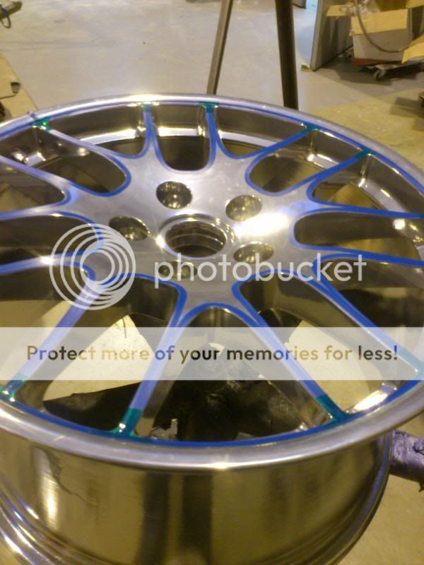

TBH I wouldn't bother, If I was doing it I'd chemically strip them, pressure clean, media blast, prep, prime, base, (in this case a butt load of masking and faff) black, clear, refit tyres, new valves, balance and fit back onto car.
sexy nicht? :grin:

That looks great, what sort of wear and tear does power coating take? It can't be chipped then start flaking off can it?
