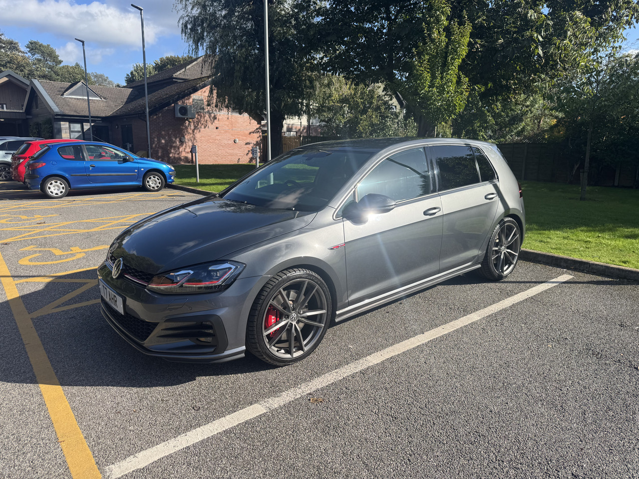

Finally able to give it a clean. Nearly 8 years old and still a great looker (IMO)
