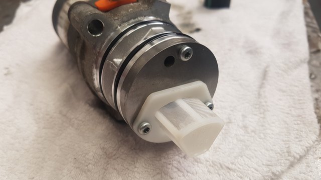

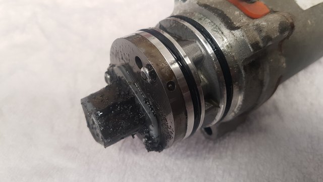

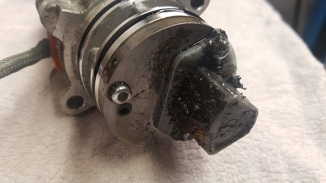

Just serviced a friends 2016 Golf R rear haldex/pump.
This is what it looked like after only 24975 miles. :sad:
After i had cleaned the pump. Loads better. :smiley:
I had mine done at 3 years / 13k for that very reason.

Finally got round to changing my VAQ diff oil this morning as i was unsure if it got done before i took ownership.  :huh:
After buying VCDS, and sourcing a laptop along with the necessary oil i cracked on.
The oil looked quite clean compared to the R i did the other day, and when i pulled the pump out there was nothing evident on the screen filter or in the aperture where the pump fits.  :smiley:
It was either done at 30k/3years or the VAQ front diff doesnt work as hard as the R rear diff and runs cleaner.
That clean i didnt even take a pic!! Anyway ive enough oil leftover to do it again next year to bring it back in line with the recommended every 3 years interval.

@madstaff, that’s interesting, thanks for posting- particularly as it vindicates my decision to defer my vaq service to next year- as mine has only 22k on the clock
