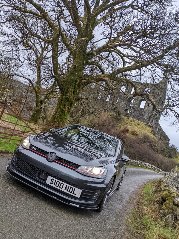

Does anyone know if there will be an appreciable power loss by mounting the plate here?
It will definitely affect the intercoolers efficiency being that it is already mounted behind the aircon condenser, now restricting even more flow to both the intercooler and radiator by effectively blocking off 30-40%+- of the flow it usually sees.
I have never understood the idea of blocking the radiator by moving a plate over the grills and away from the bumper where it doesn't cause any sort of restriction to airflow.. I assume some like to be "different".

« Reply #11996 on: 12 January 2022, 17:05 »
I must admit I do think it looks pretty cool (would look better with a shorter plate) but I don't personally think it's worth it, limiting a performance car with something as minor as a number plate.
I assume the "clips" mentioned in the relevant post allow for the plate to be easily removed for photos.

« Reply #11997 on: 12 January 2022, 18:01 »
A number plate positioned to the side isn’t really my cup of tea - unless it’s an Alfa Romeo - but it’s good we don’t all like the same things.
If I did relocate the number plate, my car OCD wouldn’t let me leave the original number plate fixing holes in the bumper exposed - I’d have to get the holes filled and the bumper repainted. I really like the wheels though in the first picture that @SionOnTheCob posted.
