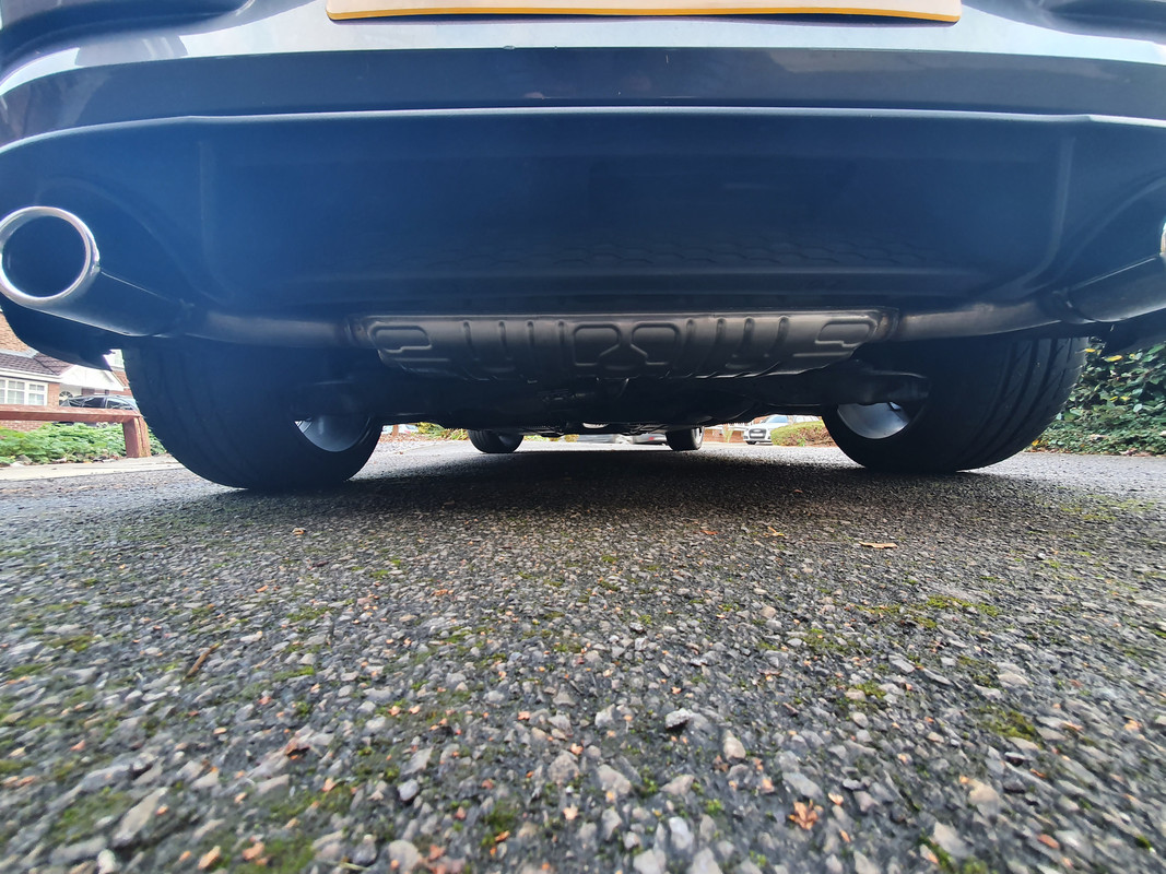

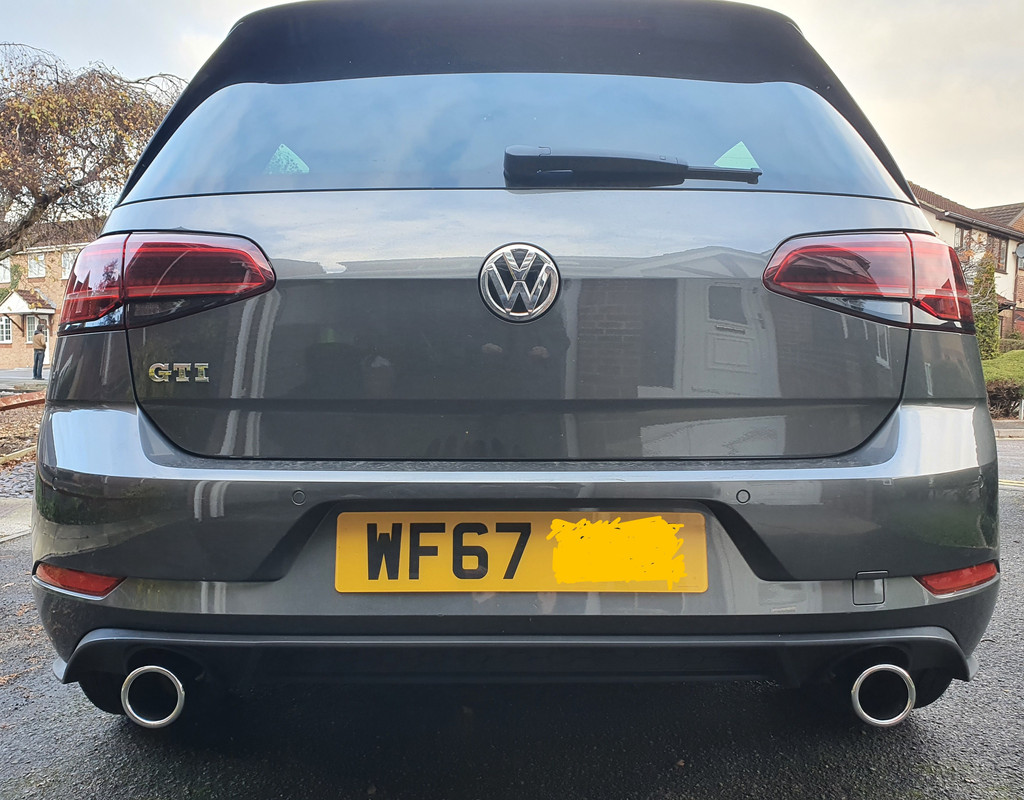

TCR backbox fitted!
There are quite a few posts about this upgrade (I know as I read them all) but thought worth adding my thoughts, so here's my 1 hour in review.
Managed to source the part from a UK parts supplier LLL parts for about £400 delivered and arrived in under 2 weeks. The part number is 5G6253609ED although the part shipped to me had the Seat Cupra equivalent stamped in the metal, with the VW part number on a sticker. Theyre identical though.
As I've got a 2017, the exhaust bore is 2.5 inches behind the backbox which matches the TCR and so it was a direct fit using an OEM exhaust sleeve (part 1K0253141AA). Took all of 10 minutes for the exhaust place to fit.
Now the important bit - sound. Note that my 2017 is non performance and without a particulate filter. I've not had a cold start yet, but immediately from getting in when it was fitted and giving it a few blips you can tell its more free flowing as there is a small but noticeable overrun when letting off whereas the stock exhaust immediately dies down when you lift off. It has a deeper and more meaningful tone than the standard box, however completely OEM sounding and as many have said, it's just like the gti should have sounded from factory.
There are no real changes to the characteristics in terms of pops and bangs or burbles but there is definitely more character, and its less hoover-like.
Under normal driving, you wouldn't know it was there, which is exactly what I wanted. With windows up, the extra noise is comparable to the soundaktor in sport in terms of volume and also in that its only there when you put your foot down. Zero drone at motorway speeds.
The main thing I've noticed is that with the windows cracked you can now properly hear the exhaust. Before I found that the extra wind noise from opening the windows pretty much drowned out the stock exhaust.
I'm very happy with it and for me it's worth it for the current noise gain, however many have said that over time as its run in and the carbon builds up it gets slightly louder and deeper, which I am not against.
I saw a comment in another TCR backbox thread that said this is not a revolution, but an evolution compared to the original, and so far I completely agree. I also love the fact that the backbox and clamp are both brand new OEM parts, and I imagine only the most switched on VW staff would even notice its not standard.
Overall, for anybody who doesn't want their car to look or sound "modified" but wants to improve the exhaust noise, I can't recommend this enough.

I was hoping you'd put me off this idea, but you're only encouraging me. Although I've a GPF so not real noise gains to be had, might as well just turn my soundaktor back on.
