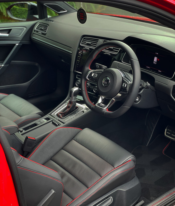

Spilt coke all over the centre console yesterday so was cleaning that up, while I was at it gave the leather a deep clean to stop it getting shiny.
Can I ask what you used to clean your leather?
I notice your getting some indentations on the drivers seat, same is happening to mine after only 2 years.
My passenger seat isn't although its doesn't get the same amount of use.
I'm guessing VW would just consider it as fair wear and tear?
Both my previous GTD and the current GTI had leather. It's not indentations it's just the leather covers are loose from poor foam base/poor cover fit to be honest.
The GTI (a year newer) actually has it worse than my old GTD (Which my brother has) it's just luck of the draw on how well it fits.
I have seen people get the foam replaced if the bolster has worn prematurely but that's about it. Personally I think it would be a bit of a reach to go after it on warranty on my car. If you think it's bad on your car then go for it, worst thing to happen is to be told no!
But I've seen new AMG's with the same amount of play as mine in the leather covers so I'm not worried.
It’s normal with leather which, being a natural material, will develop ‘pressure dents’ over time when subjected to the weight of someone sitting on it if the leather cover has a degree of slack in it. VW wouldn’t consider there’s anything wrong with it. If you look at pictures of used Golfs with leather seats of a similar age, you’ll find most - if not all - will have similar indentations.
I’ve read that heat can be used to remove these dents; I don’t know if I’d attempt it though and I dare say it’s not a permanent fix, and the the indentations will reappear in a relatively short period of time, once a seat’s subjected to a person’s weight again.

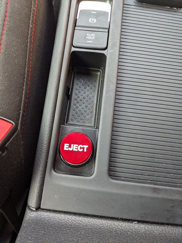

Ejecto seato cuz!   :evil:  :laugh:
