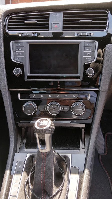

Fitted the 8 inch glass screen from the MK7.5, what a huge improvement!
Straight swap, no coding required. Highly recommended upgrade.
Only took 10 minutes... :cool:
Before:
After:

Agree the new screen looks great. Did you buy the screen from VW? Really surprised it took only 10 mins, good job!
Can you provide some further info Richard?
Cheers.
2026 Golf GTI ED50 ordered
2016 MK7 Clubsport ED40 - still hanging around

Does everything work properly. These have usually got component protection on, unless you bought it with it already removed.
Cheers.
I bought the screen and surround from a guy on a Golf R parts forum, he'd upgraded it with brand new from VW but was trading his car so swapped it back to stock. The screens are easy to find as they're common to a few models of VW, it's the surround that is hard to find used. You just need to keep searching and get lucky or buy new.
Like here for a screen:
 https://www.ebay.co.uk/itm/VW-GOLF-MK7-CONTROL-PANEL-DISCOVER-MEDIA-MIB2-BRAND-NEW-5G6919605B/254630258812?epid=8011986446&hash=item3b4925687c:g:3XUAAOSwA1pazN6K
and here for the surround:
https://www.oemvwshop.com/5g2819728ajqyi-vent-satin-black-black-it-up-p1513347/#gallery
You must have MIB2 and a 6.5 inch screen to start with to have the right resolution, then it's a straight swap. Doesn't work if you're on MIB1. 2016 was change over year I believe so all clubsports should be fine for example, you also need Car-Net for full function with the APP button going to Android Auto or Car Play.
Golf GTI CS40 #010 | Manual | 5 door | Pure White | Car-Net | 90% tints | Winter Pack | REVO stage 1
All works perfectly.  :smiley:
