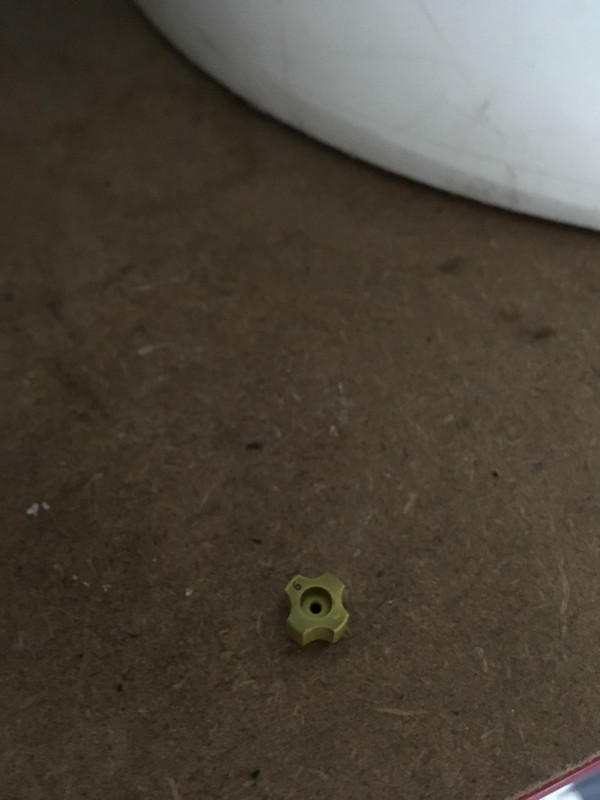

Took the clutch delay valve out
Definitely feels better with the assist spring removed and this done

I've removed the assist spring and added the clutch stop but didn't get around to this mod, are you able to say in what way it has improved? Cheers :smiley:

It makes the clutch bite point more consistent and reduces the feeling that your slipping the clutch when pulling away
With the delay valve in place the bite point varies depending on how quick the fluid can move back and forth. Going from 1-2nd gear the bite point is noticeably different
It now it feels a lot more normal
Also done the direct throttle setting on VCDS. Not massively noticeable but is slightly better when pulling away.

It’s not hard to do probably took 20 minutes bleeding the clutch with a vacuum bleeder
