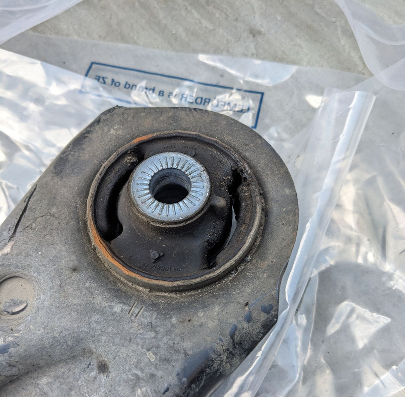

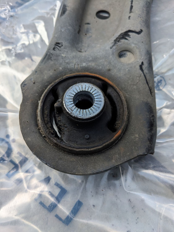

see updated post in the OE damper thread, but basically just wanted to tighten the car up a bit. and at 5 years old they aren't likely to be performing like new.  Also while gearbox and oil were changed it was a 10 min job (for the mate doing them in his workshop  :grin:)
The back bush is really tucked inside the subframe and you can't easily see it until you take them out.  As you can see I'm glad I changed.

Are your keeping the standard rear front LCA bush with the voids - one of the best and cheapest mods I have done was to changeover to the CSS bush - there is a void but it is much smaller, like 95% smaller than the standard bush. No increase in NVH, just crisper, more precise steering 😊
