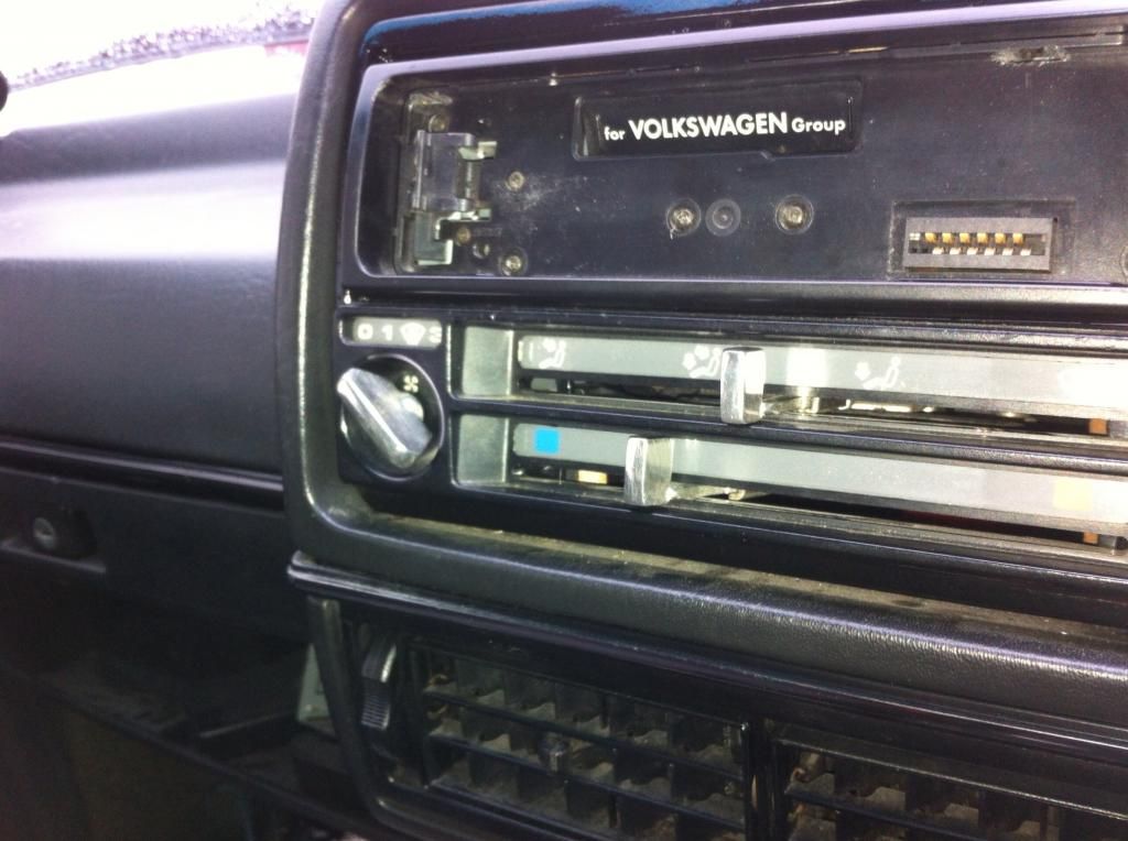

New heater controls needed a bit of filing to make them fit and they haven't got the best of finishes on them but think they look ok.

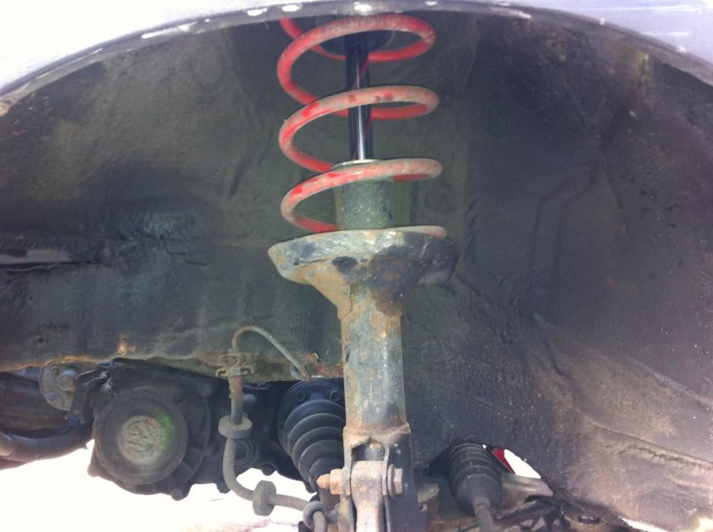

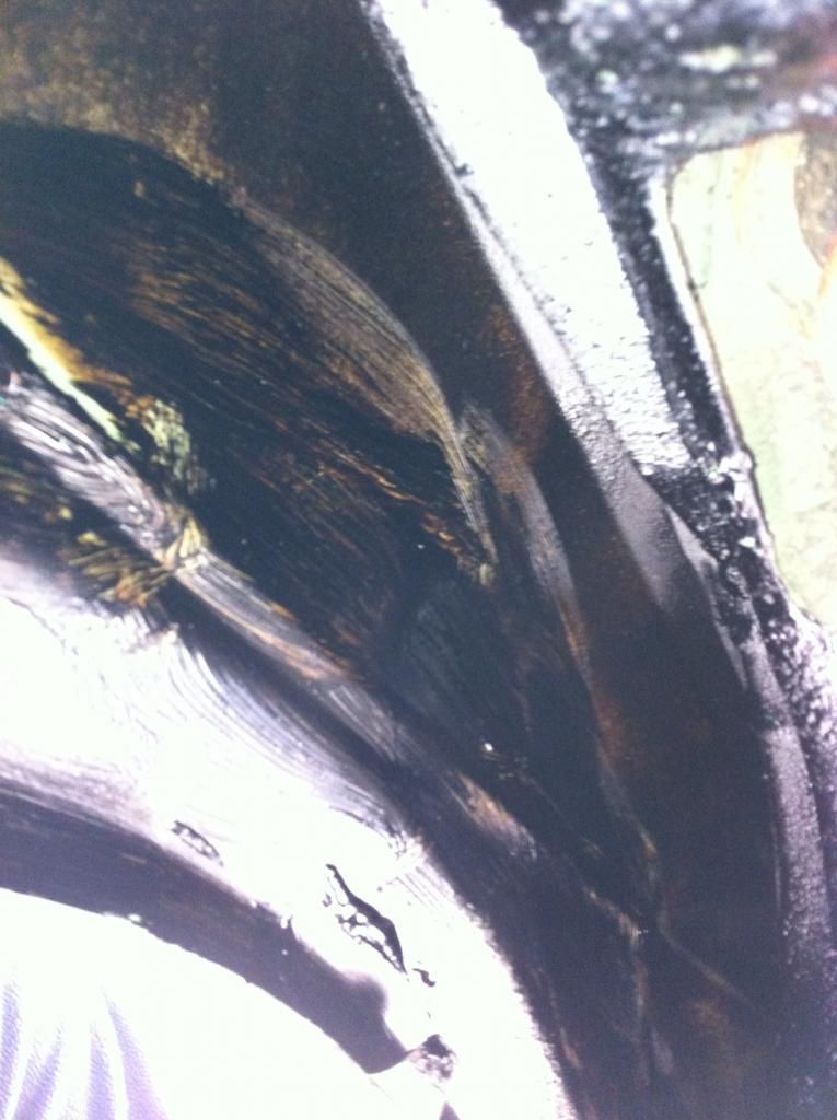

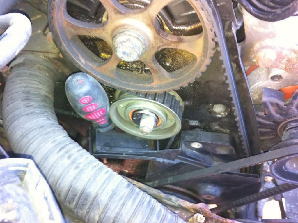

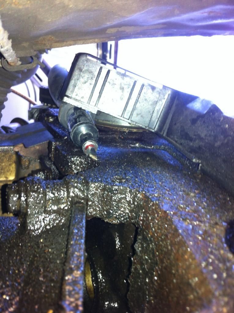

Had a closer look at the water leak this morning and this seems to be where it's coming from.
Not sure if that's where the water pump is? Any feedback would be good guys.

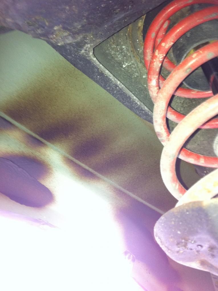

So after taking the wheel off to inspect the water leak I noticed the bodyshop had not oil sealed the inside of the wings as much as I would have liked.
So off to the shop I went.

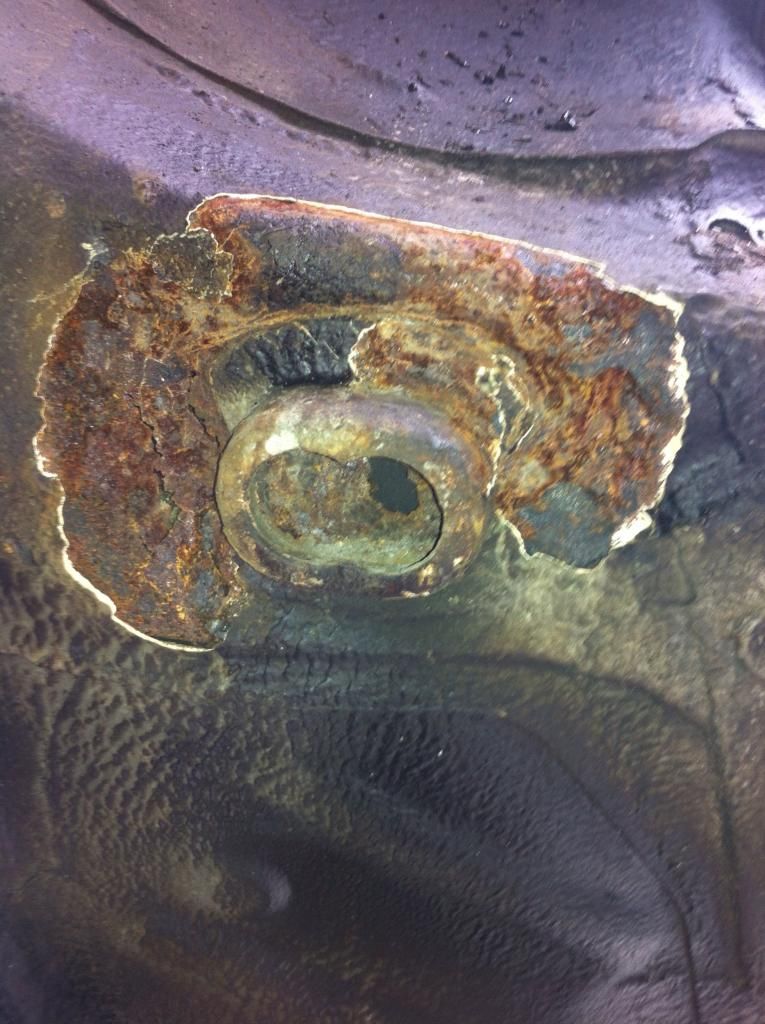

So jacked the car up on one side and sat on axel stand then jacked other side up and, oh crap.
Rusty jacking point, now don't judge me but just a bit of a quick fix.

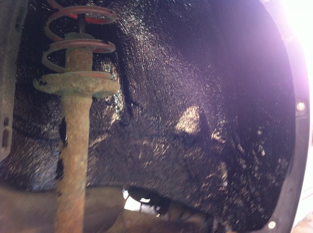

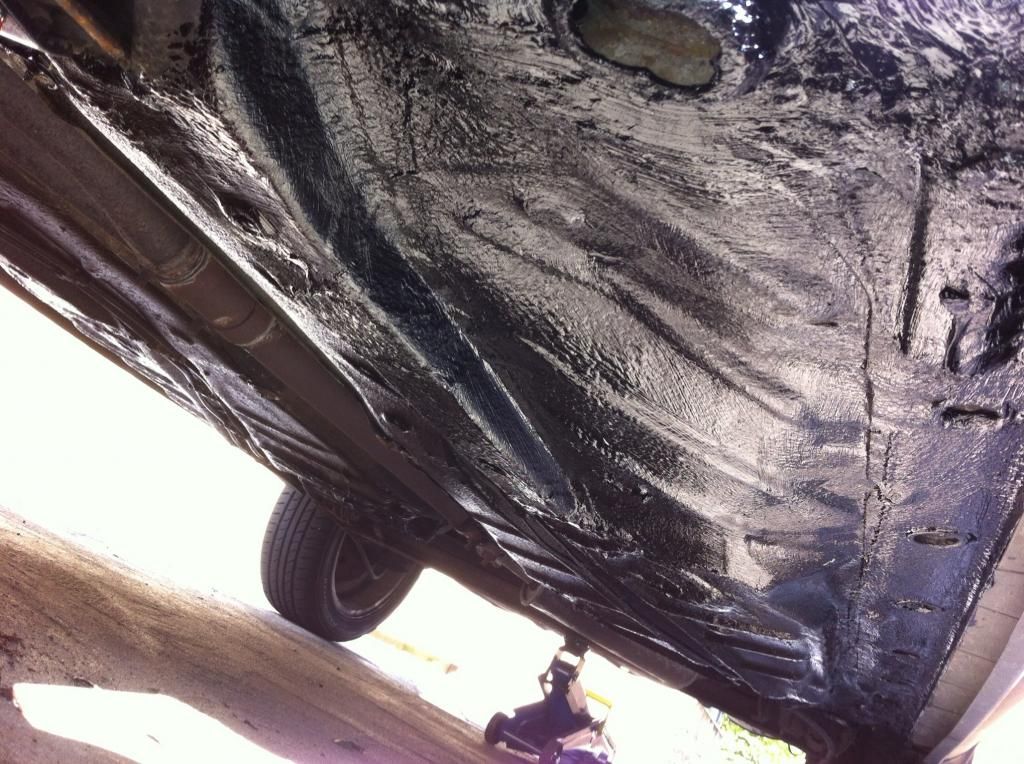

After my bit of filling I started wax oiling and undercoating. Was really pleased with the finished result got in every nook and cranny :cool:
After a full day off undersealing and wax oiling the old girl I tryed to fit the bonnet gas struts but dint really go that well :sad: going to attempt them again tomorrow.
Was wondering if I should buy myself a mig welder to sort the new hole in the floor out. Not done any welding before but have always wanted to give it a try but haven't got a clue on what welder to buy. If anybody could give me any advice on what I should be looking at getting, that would be great :smiley:

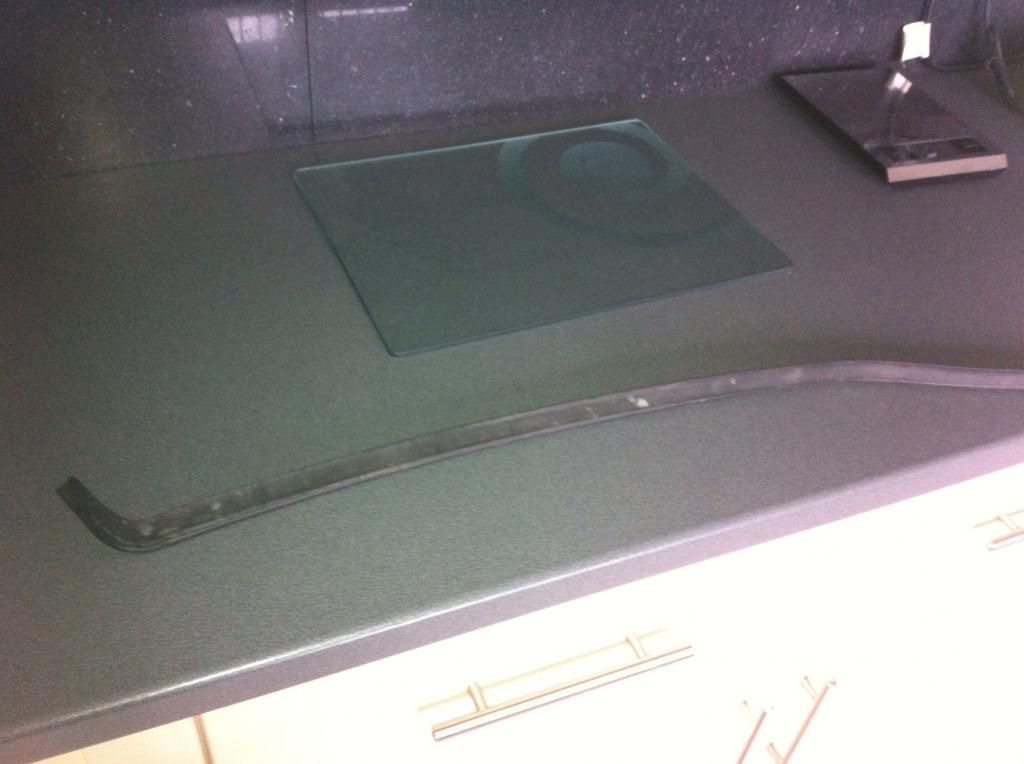

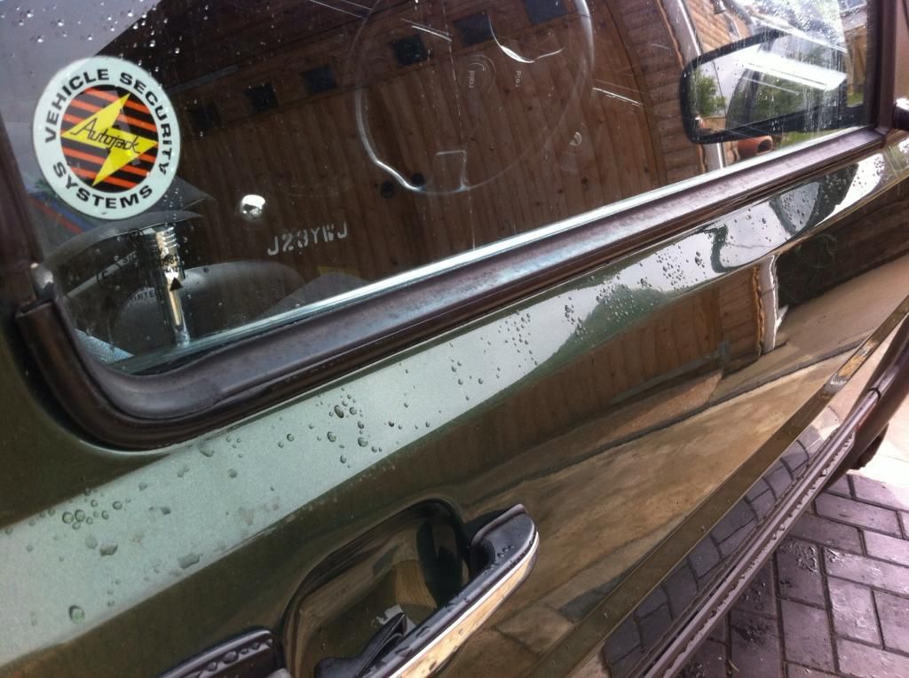

Thursday morning took deliver of outer window scraper and what a load of crap! The bloke who had sent it had folded it in half :shocked: and it was badly perished and to short. Ebay :rolleyes:
Dint look to bad after a bit of cut and shut with the old one

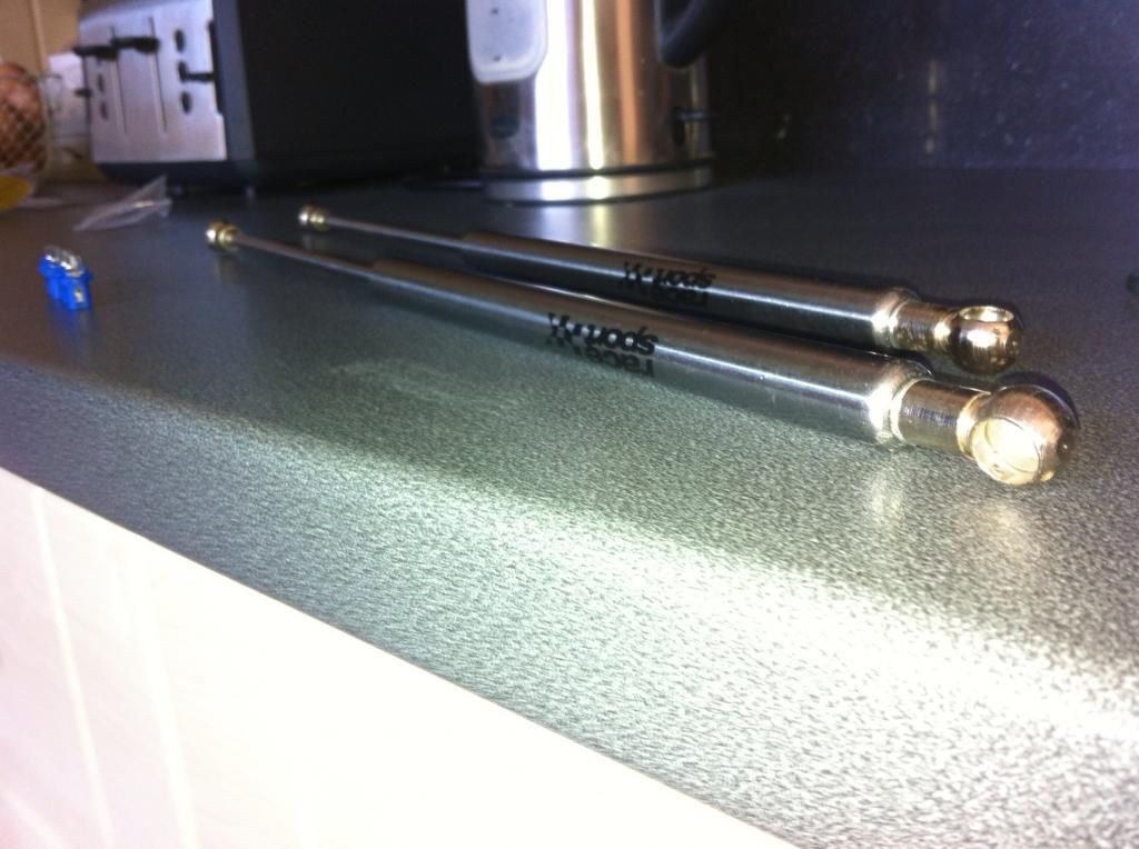

Next job was to sort the bonnet struts out.
Had really been struggling the nite before to get the nut onto the bolt end through the bonnet because you could not get two fingers through the hole. Hope pic gives a better explanation.
Anyway after much thought had the idea of sticking the nut to my finger with silicon then putting finger through hole and pushing it against the bolt while tightening. Genius  :wink:

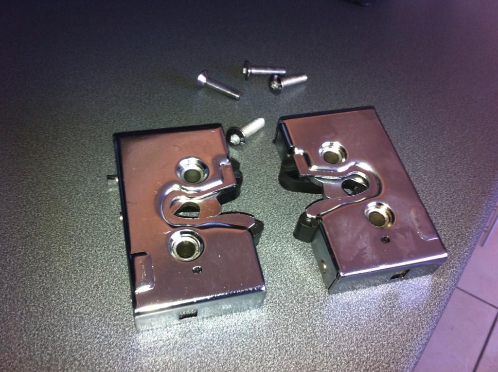

Next was to fit the new door latches, easy job and tidys it up a bit.
Broken one before.

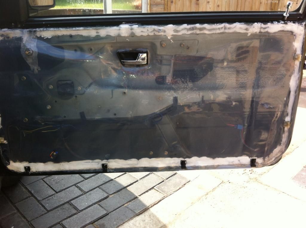

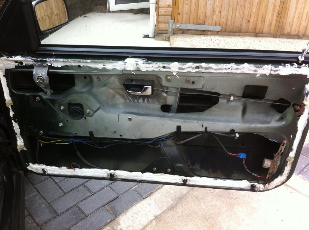

Bit of an update, fitted some plastic to the inside of the doors. Somebody had previously fitted some but had a bit of a mess with white silicon. Couple pics.
Before
After

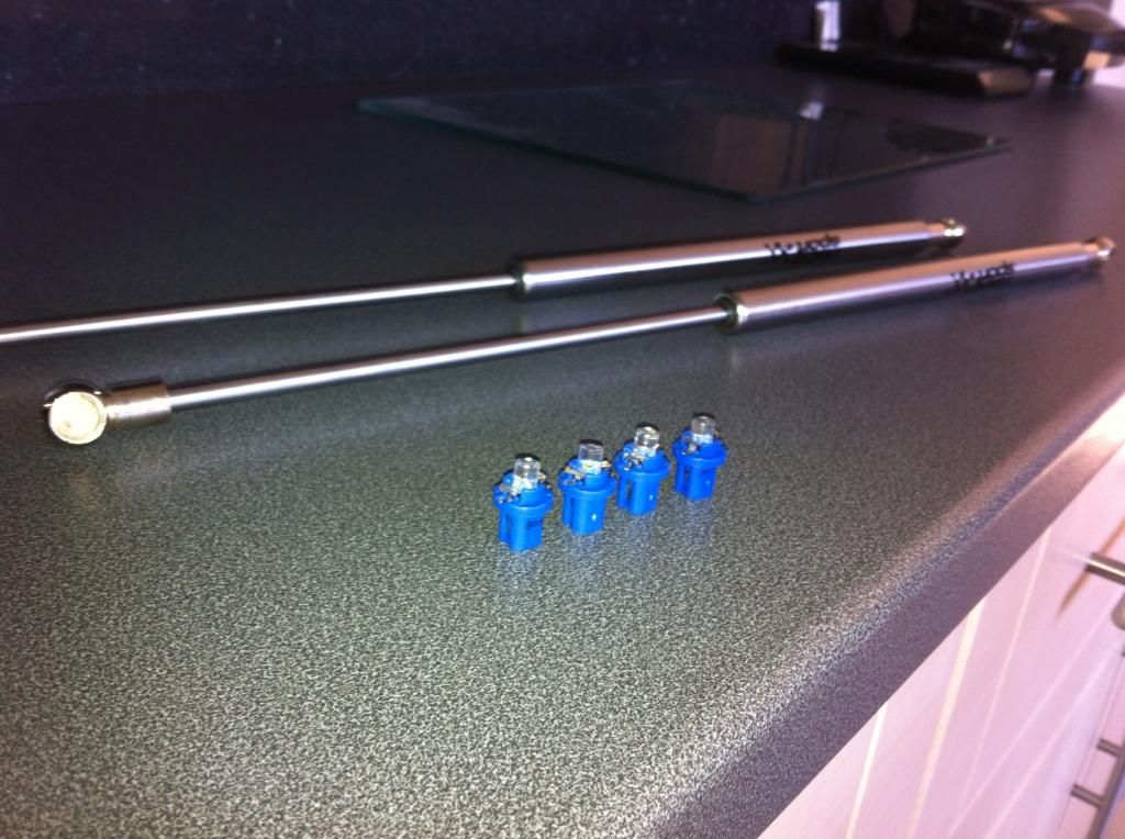

New door striker pins turned up yesterday.

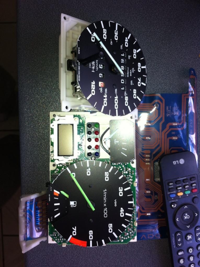

Doors shut a lot nicer now, also got some led bulbs for the clocks. Thought I would paint the needles while I had them out.

Water pump is directly under the alternator bolted to the front of the block. The alternator belt runs round the crank pulley, water pump pulley and alternator. Should help you spot it.
