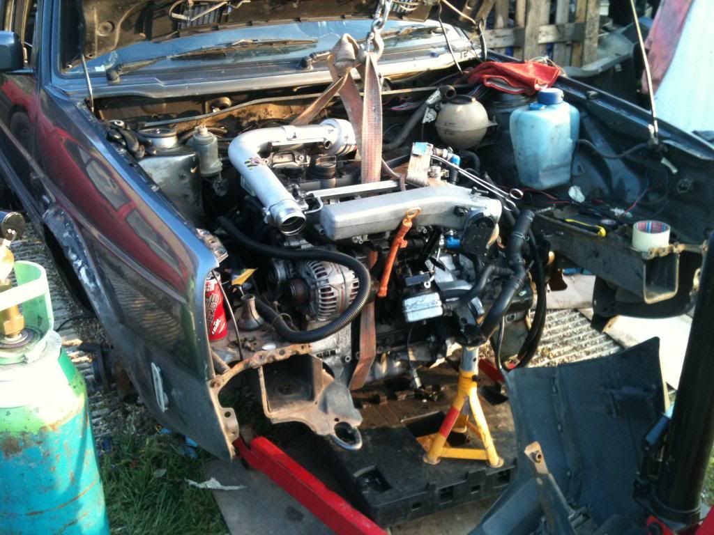

and it was time to install the new engine. Went quite smoothly.
Front end on
