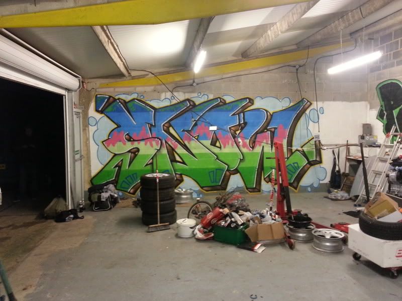

Thats the size u kinda get the size comparison of it its an old cattle shed that have all been converted im guessing its decent concrete under whats been poured on the smooth bit thats there now need an expert i rhink lol

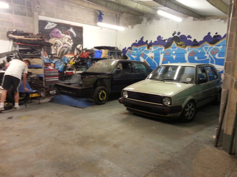

 please excuse the sh!thole state of the workshop

doesn't look like there's much height there to me.
