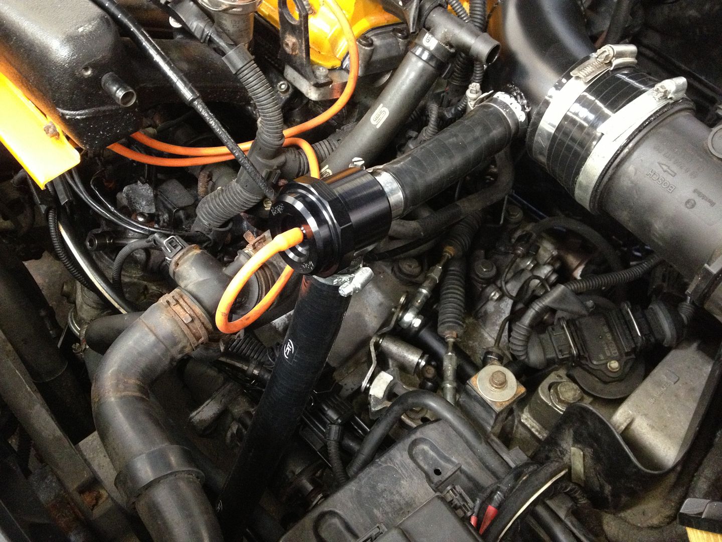

Shiney new DV from Forge plumbed into it's new home:

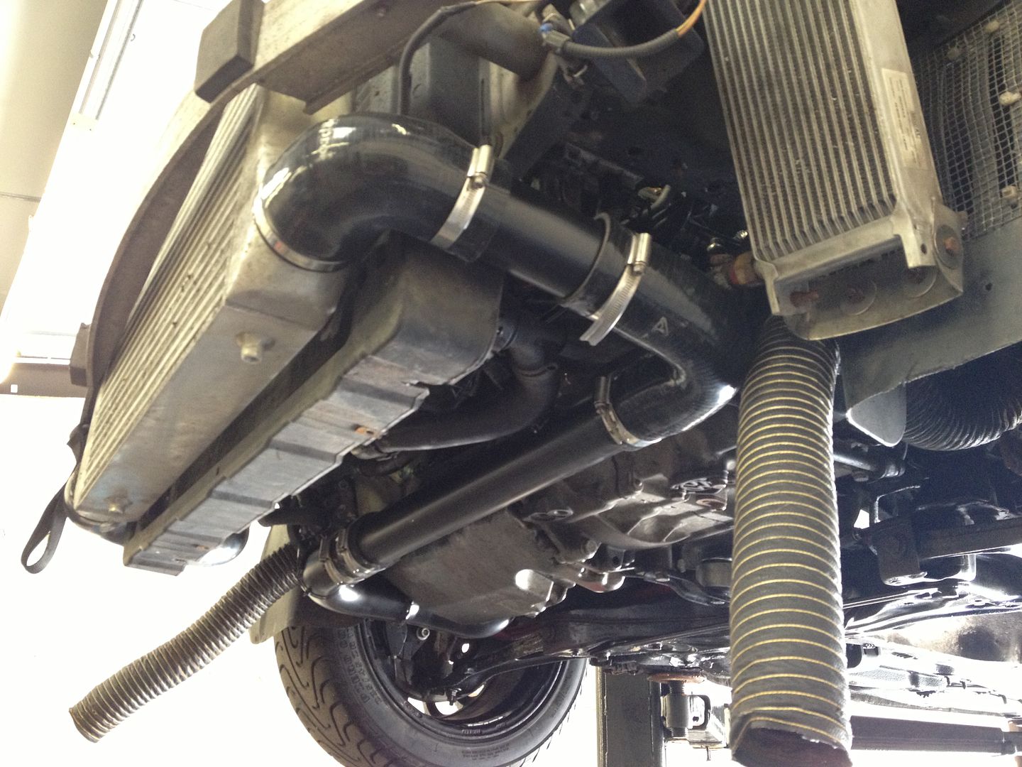

Charge pipework all welded up, painted, and fitted:
With the bracket by the crank pulley, the main cross member is actually really solidly mounted. We were going to brace is, but somewhere it needs to flex for engine movement, and across the length of pipe made the most sense, as the angular change when it flexes will be the least. Long term I will replace the straight coupler with a bellow I think.

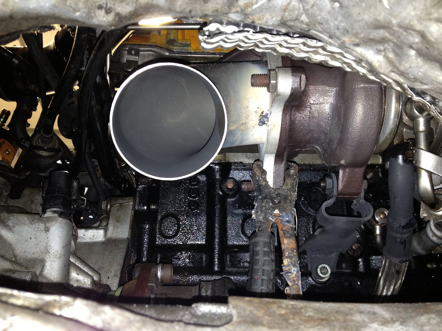

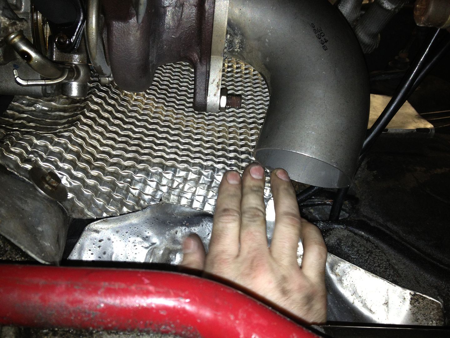

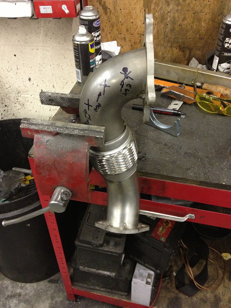

90 degree pipe offered in and pointed to roughly where we wanted it:
A remarkable amount of room for this, the only thing reasonably close is the gear shift cables, but the DP will be heat wrapped, as will the shift cables.

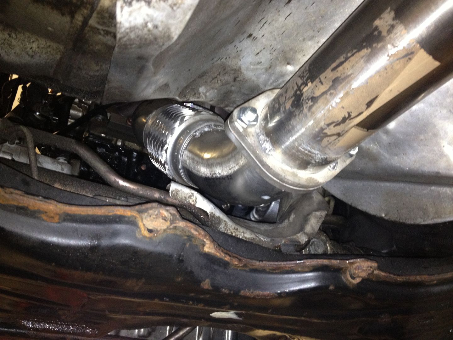

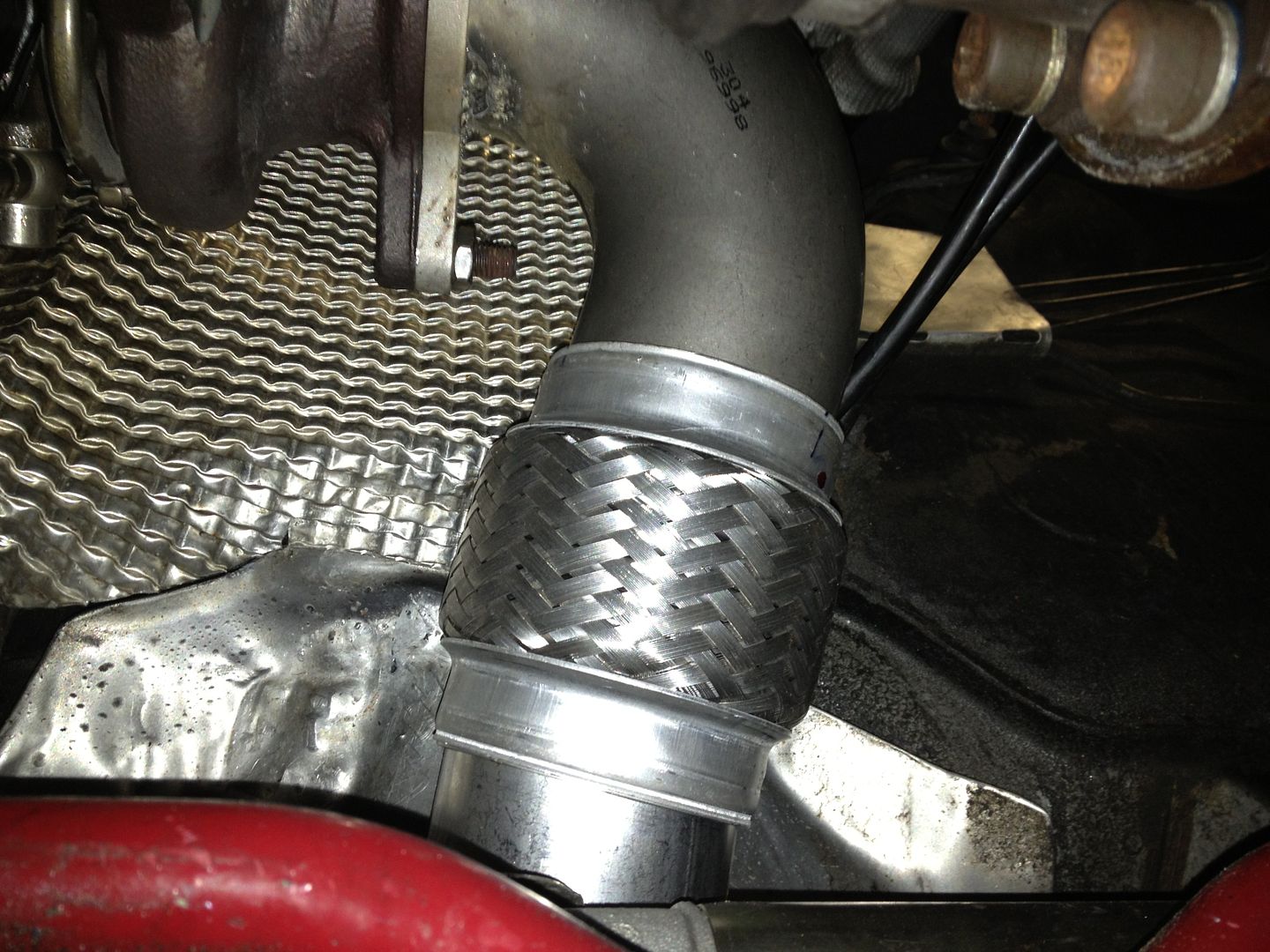

Flexi on next:
Followed by a 45 degree to bring it into the tunnel:
And that's all there was too it! Made easy thanks to Ben!
All marked up for bosses, EGT, Narrowband 02, WB02 all to be welded in:

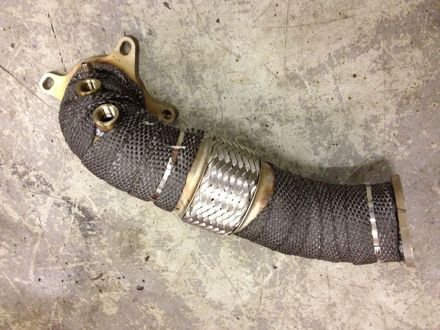

Downpipe welded up:

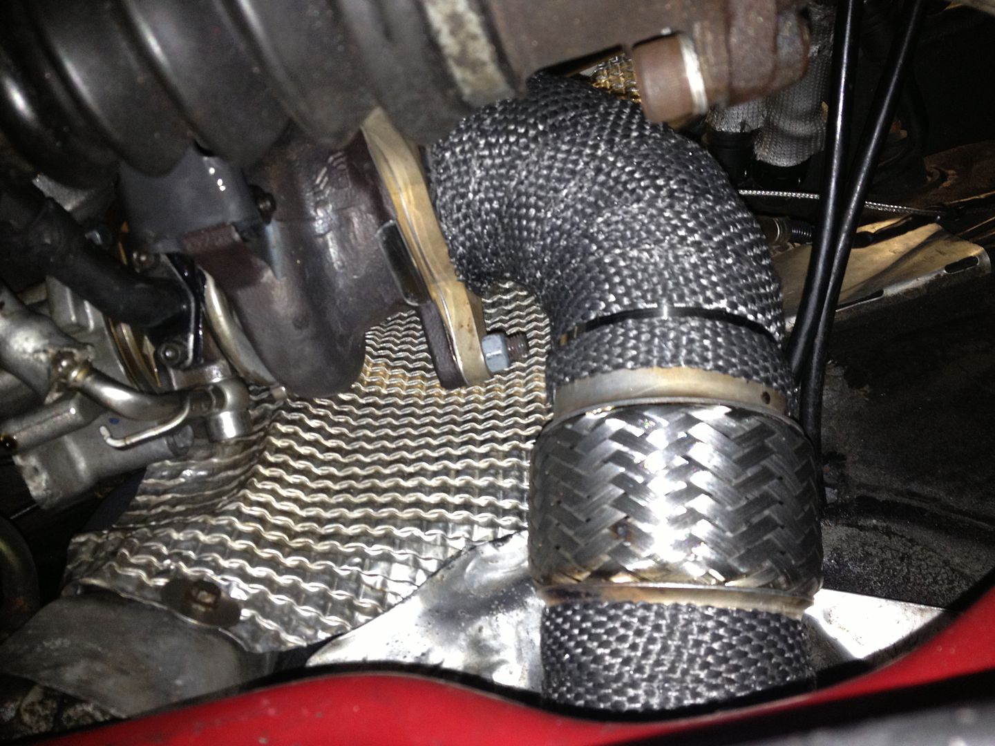

And wrapped:

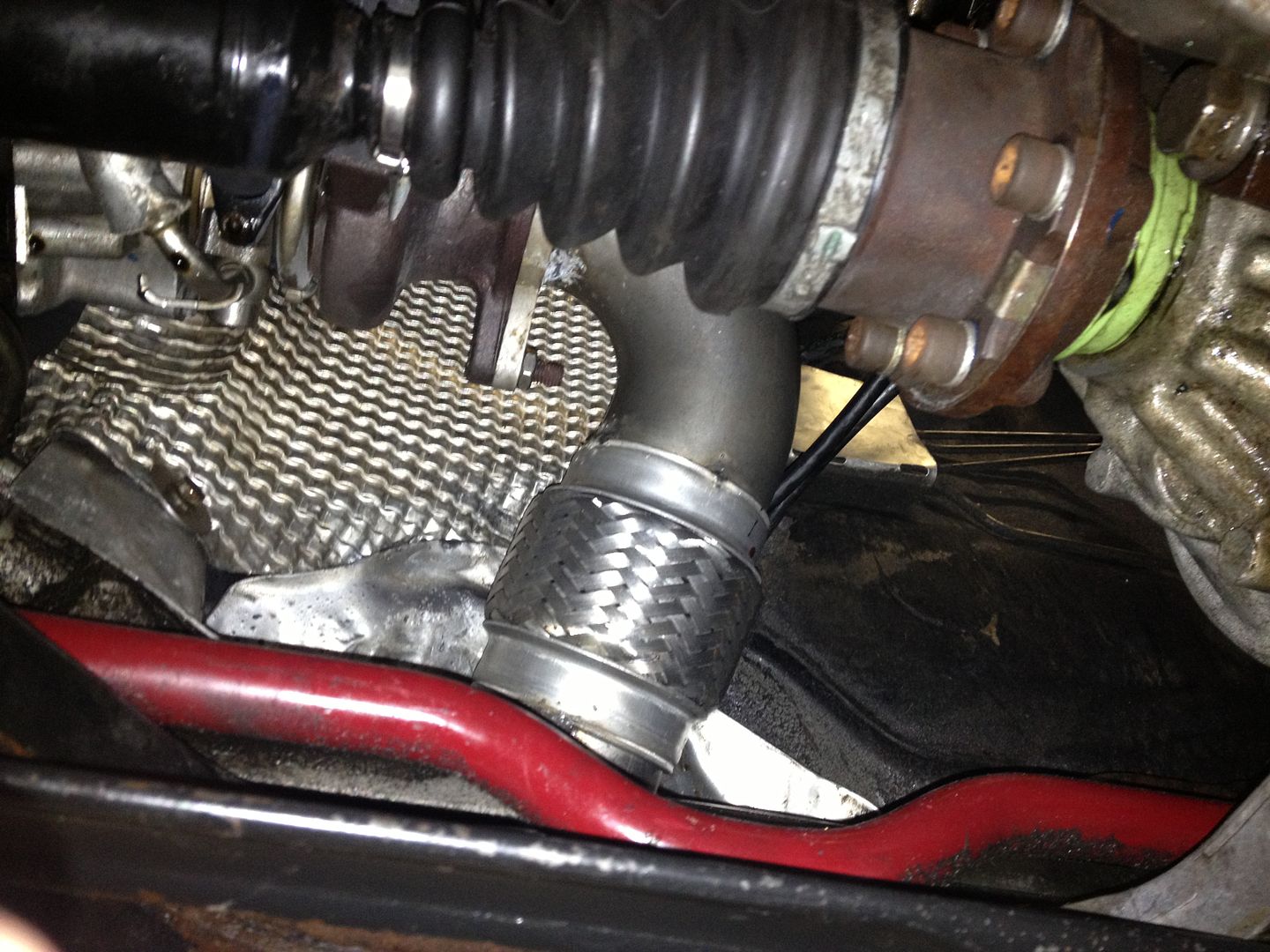

and fitted:
