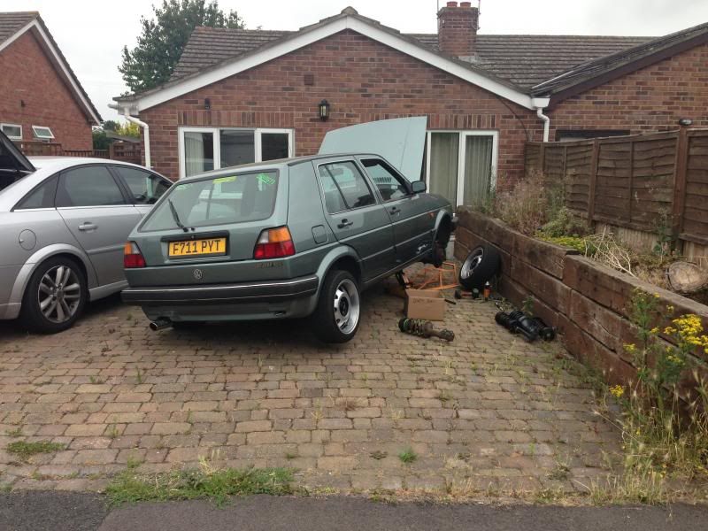

God your getting old Foosey , slam it up onto one wheel, leave it on the jack and crack on with dropping the front struts off  :evil:
