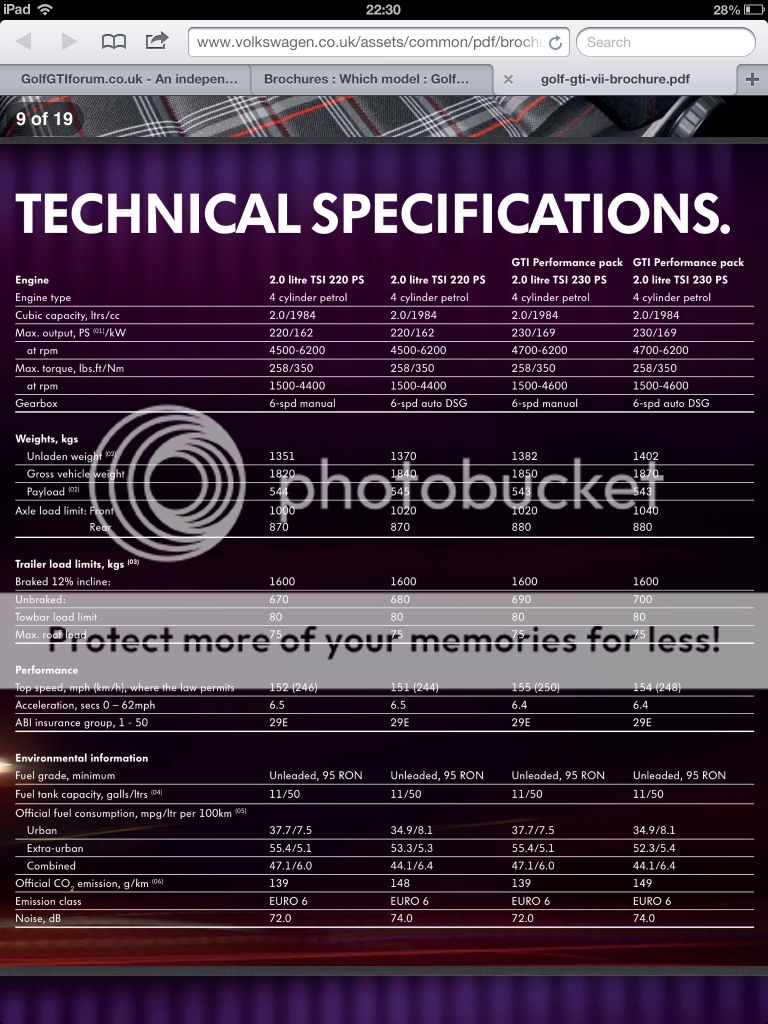

VW don't recommend using 95ron, it's a minimum requirement....

We'll I am sure they would recommend 98 just like the mk5 if it was better

So why did they "recommend" 98 for the mk5 then?

It was made to run on 98 the mk5, if you look you will see that they changed the new engine in the mk6 to run on Ron 95 as it said on my fuel lid, to save money on pointless 98

If VW state 95 as a minimum (which they do) but do not recommend 98 in any of their brochure material, then I think it's safe to assume that output, mpg and CO2 figures are based on RON 95 fuel use. If you could get higher output or mpg with the routine use of RON 98, i'd expect VW to be making that clear in their literature (quite prominently), hence i've assumed no benefits of using RON 98 fuel.

In the old MK5 brochures said Fuel grade, minimum:
5) Thanks to the knock control, unleaded four star (at least 95 RON) can be used instead of unleaded Super plus. In order
to achieve maximum fuel consumption benefits on the FSI engine, Ultra Low Sulphur Petrol (ULSP) must be used.
However the cap had a big 98 RON label.
