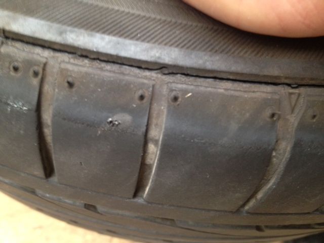

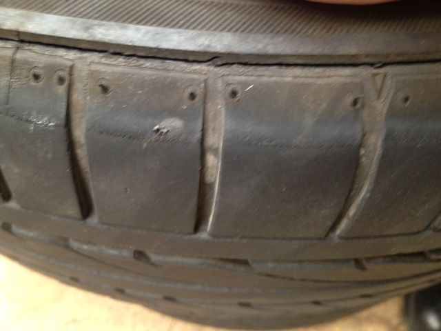

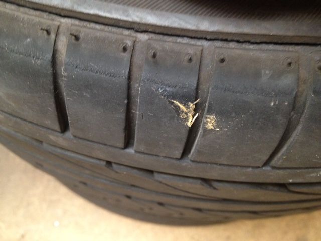

« Reply #7 on: 17 July 2013, 11:01 »
Here's some pictures:-

« Reply #8 on: 17 July 2013, 11:08 »
It's interesting that they have changed the shoulder design on the 'same model' tyre too - the amount of rubber that sticks out?
Old:-
New:-
Marshy
Re: Bridgestone tyres - PICS ADDED
« Reply #9 on: 17 July 2013, 11:15 »
About 4 years ago when I worked for Alfa Romeo it was very common for Bridgestone tyres to do exactly this.
On cars that were just over a year old and done 8-10k
We used to send them back to Bridgestone and always got compensation from them.
Pretty soon after Alfa started using continental and Michelin.
Lots if people used to rave about Bridgestone but from experience with them I'd never have them.
