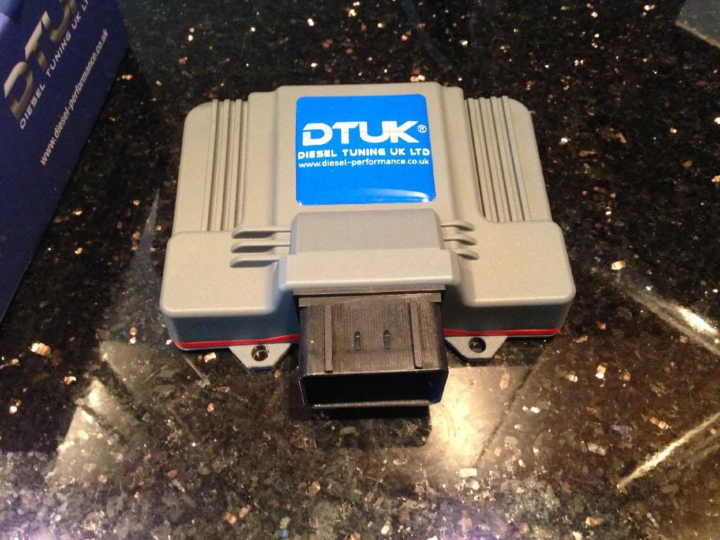

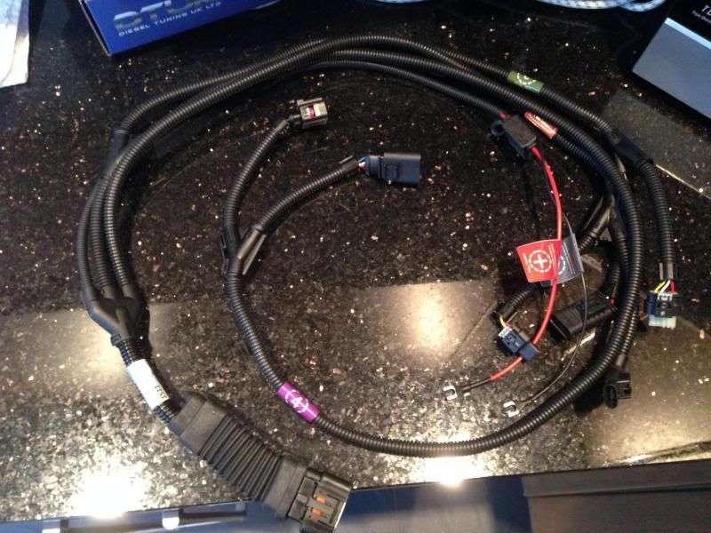

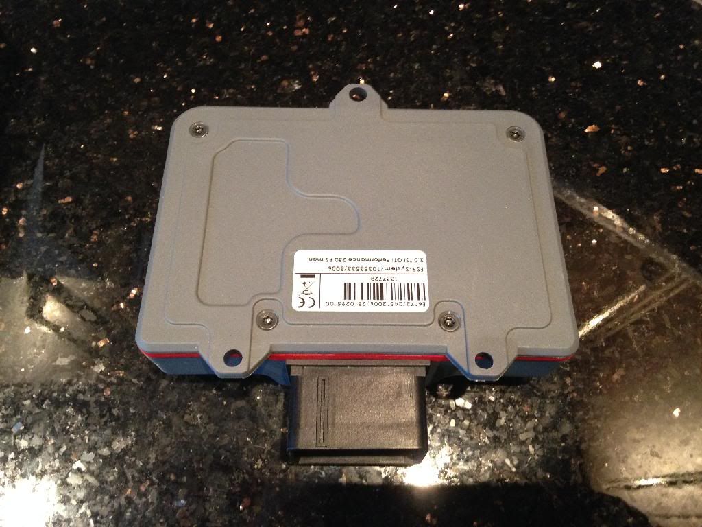

Right then spent an hour or so fitting the box yesterday. First and foremost i take my hat off to Andrew who was at the end of the phone to clear up a couple of minor issues during the install (issues which he told me about when i ordered it). I am a complete novice when it comes to tinkering with cars yet i managed to install the box in about an hour or so. Below is some pictures of my install, i have gone over the top with the pics but they sort of answer some of the questions i had when considering ordering one as i have only experienced remaps on previous cars and not tuning boxes.

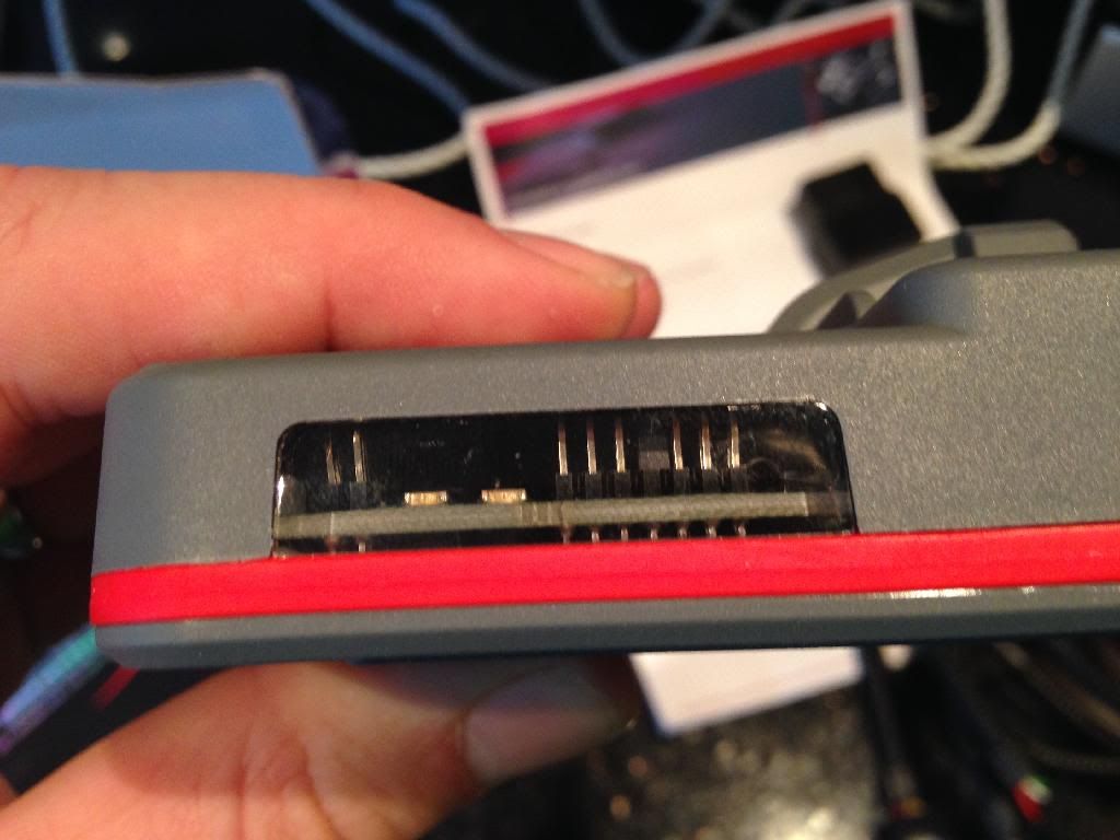

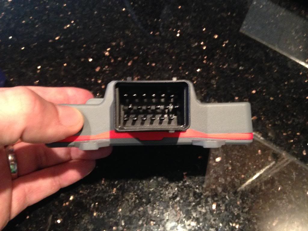

So whats in the box
You also get some cable ties, a screw head to open the box up and some stickers.

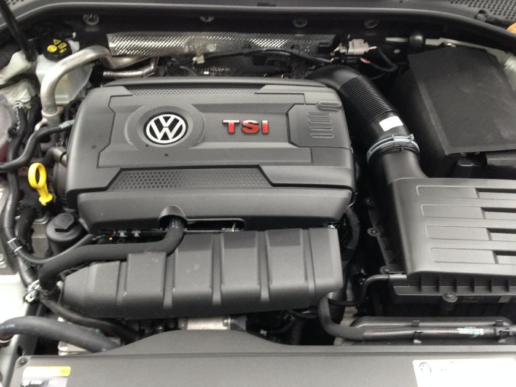

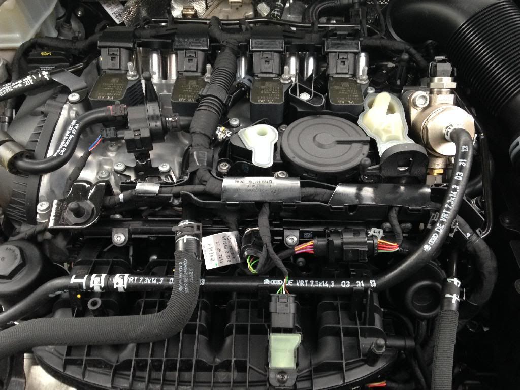

On to the install

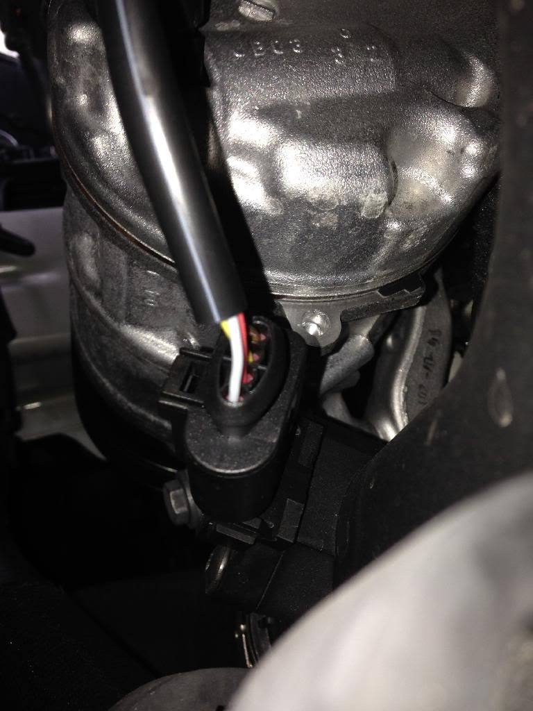

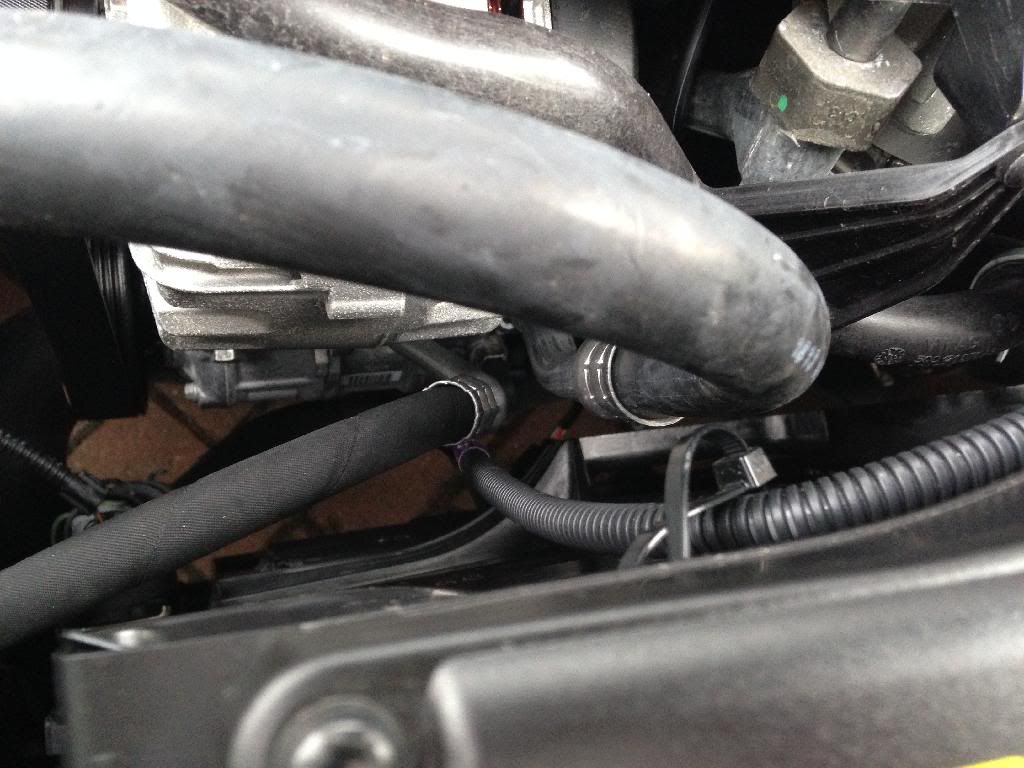

The top two connections are very easy to find. However the one towards the bottom front of the engine in my opinion is only accessible by jacking up the car and removing the plastic try. Like i say this may seem like a pain but its only a case of removing 10 screws, i didnt remove the whole tray i left the nearside corner in place and used it to pivot making it easier to put back
view of connection from under the car

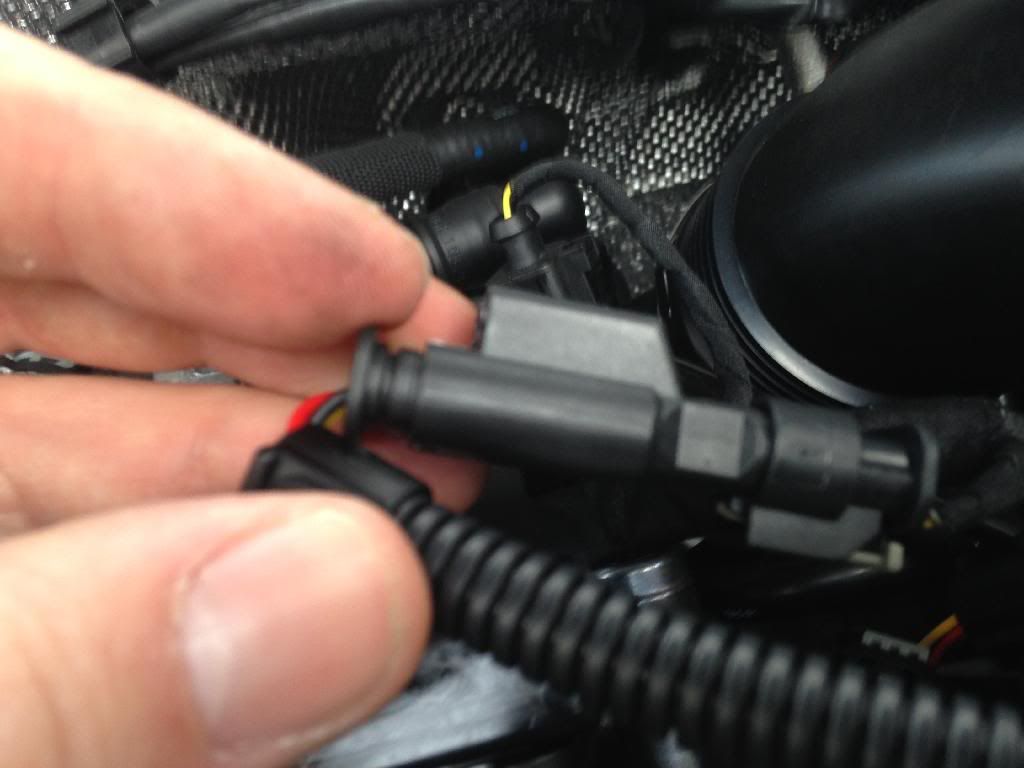

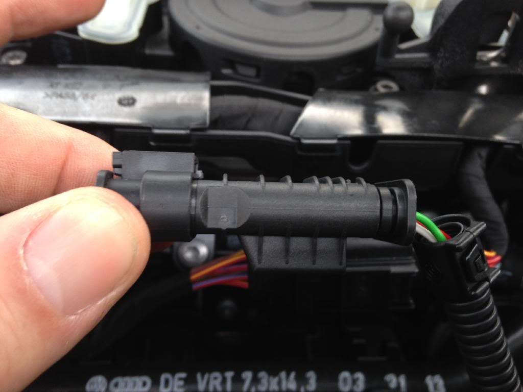

Now the issue is that the top two connections can be put in both ways so its important they are lined up so avoid engine management lights... simple explanation on the phone from Andrew cleared it up, clip goes the opposite side to the ridges like so.... (i sent these pics to Andrew to double check)

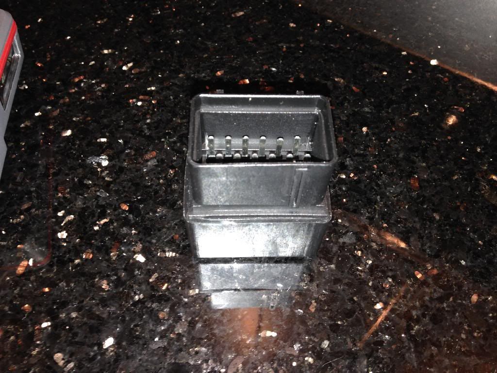

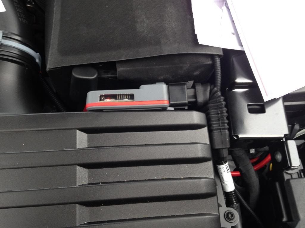

Now its a case of running/securing the cables and connecting to battery (very easy) and putting stuff back on
plugging in the box
I triple checked everything before putting stuff back and i urge you to do the same!!
