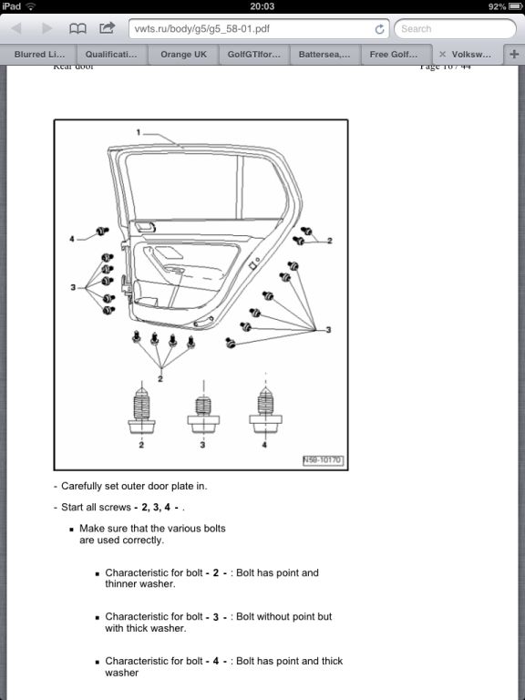

I seem to be missing a bolt that holds the door skin in place so there's a bit of play on the panel! I have no idea how or when it went missing but I need a new one but have no idea where to get one. Can anyone please help me
I need a no. 4 bolt I believe? If anyone can help it would be much appreciated

Tried your local VW dealer's parts department?

Ordered some from VW today, only 53p each so ordered a couple lol
