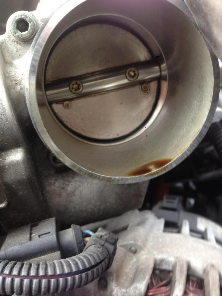

« Reply #4 on: 20 June 2013, 10:54 »
Does that look dirty?? And what is the brown stuff?? I'm guessing it shouldn't be there
Offline dom
  • Posts: 10,084
  • Back in a Mk4
Re: Asr light flashing - loss of power
« Reply #5 on: 20 June 2013, 11:10 »
Looks pretty clean, what's it like when you open up the valve?
The brown stuff is just a little oil by the looks of it

Couldn't open the valve but maybe being to soft with it how hard should I be with it??

« Reply #7 on: 20 June 2013, 12:02 »
Its normal to have abit of oil in there, you want to check the otherside as well.
Also check all your vag lines for leaks and clean your maf.
