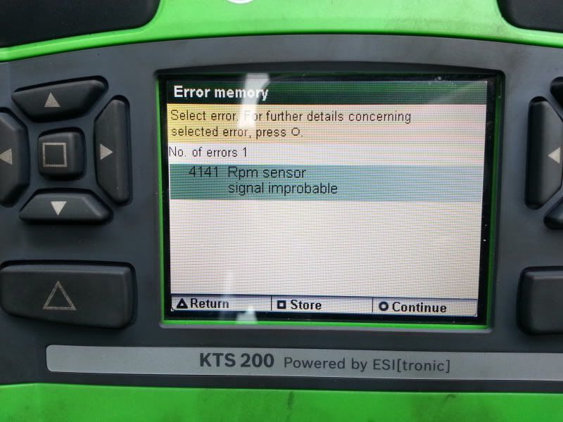

Pd150 wont start and throws a code for rpm sensor so its been changed and still throws the same code also had replaced crank postion sensor and checkd the fueling all seems fine but still wont start does the ecu lock u out

Ummmmmmmmmmmmm, is the engine getting fuel? I have no idea.
Was the problem starting before you changed the sensors?

Yeah its getting fuel changed the sensor as it would start and thats the code it kept saying rpm sensor so change crank positon sensor and the rpm sensor just incase and still no starting ?

might sound stupid, but have you cleared codes after you changed sensor?

Yes mate

have you checked the condition of the loom/ wiring to the crank sensor?. even pull the ecu out from its tray and check the connections maybe?.. long shot i know

That will be my next one i think mate cheers
