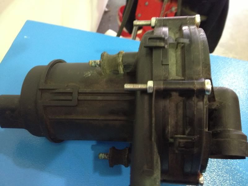

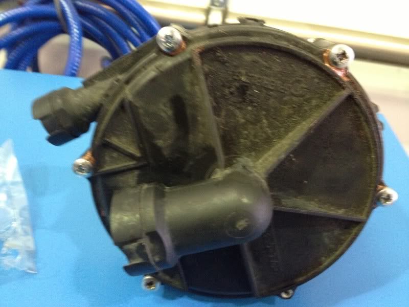

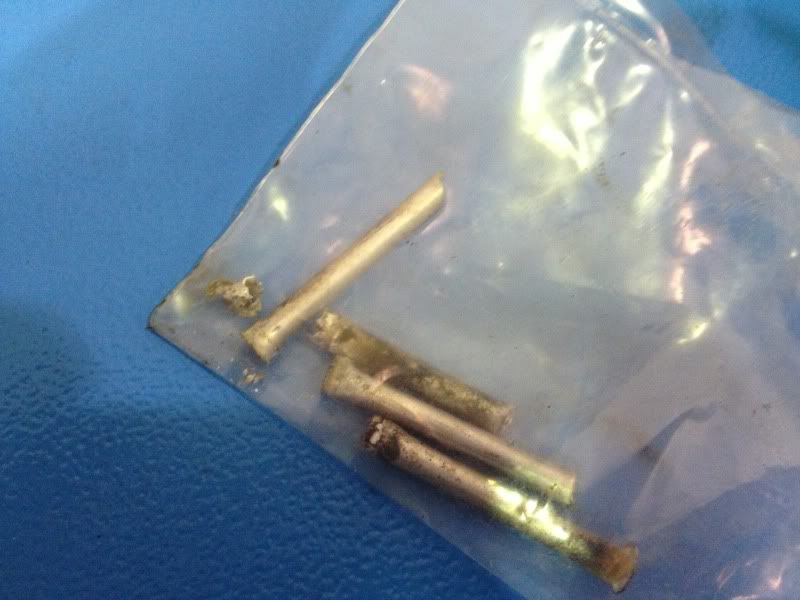

Had a bit of a quiet day at work today so i decided to fix my air pump had enough of it sounding like a hoover when it was cold so £1.75 later and shes all sorted.didnt even have to drill the rivetts out they fell out which was a result
Old rivetts

what did you do to fix it? just put the bolts in so that it tightened it up and re-sealed it or something?

Yes mate took old rivetts out and put bolts in and tightened them up could have done with smaller bolts but thats all i could get at the time realy quiet now.been meaning to do it for ages and just had enough of it today so done it at work

I also fixed mine in the same manner except I used split washers to avoid the bolt becoming loose, and sealed the edges with tiger seal. It was a lot quiter but still sounded like crap :(

I would have used washers but the shop i went to never had any so i used thread lock instead.well started it this morning and cant hear it so its iva fixed it or dont work at all haha
