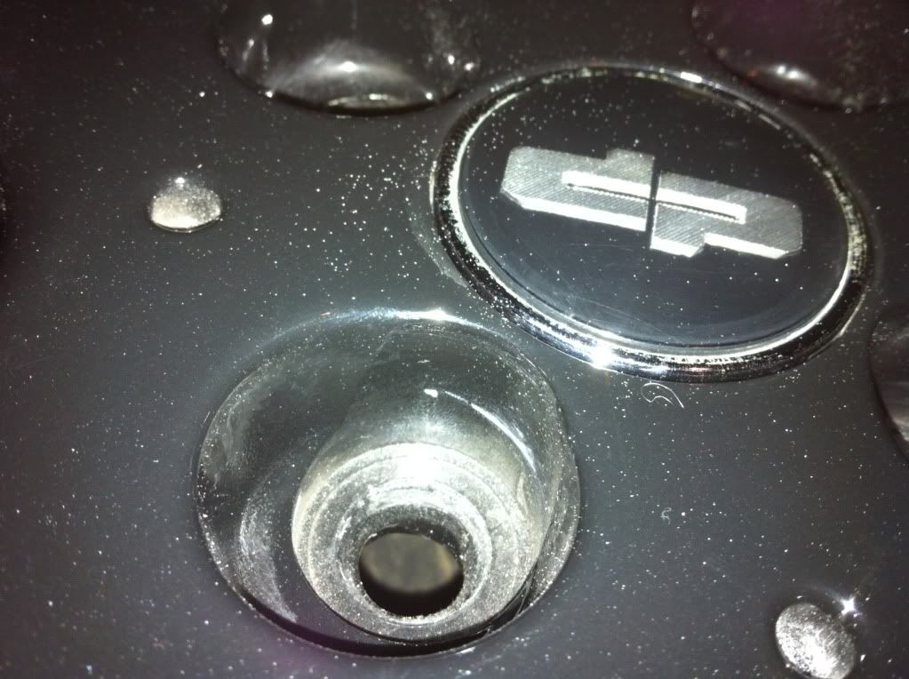

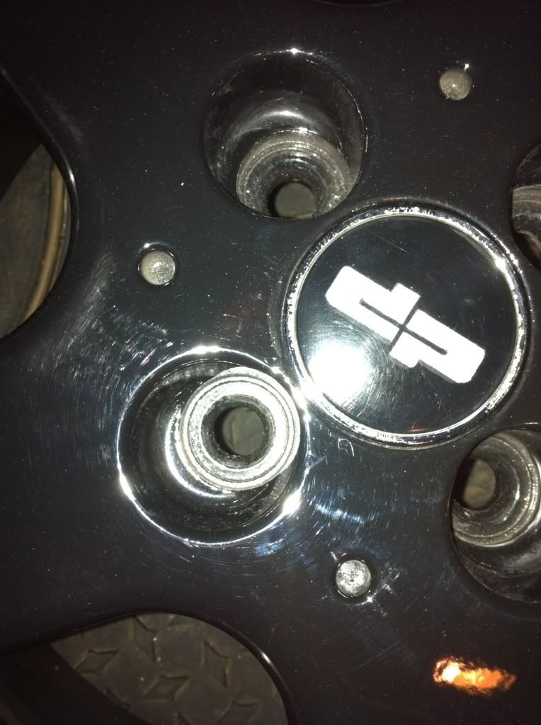

Here are some bolt hole shots but not very clear
If anything I think the bolts seat need to be more of an angle to sit snug
More of a cone seat I think

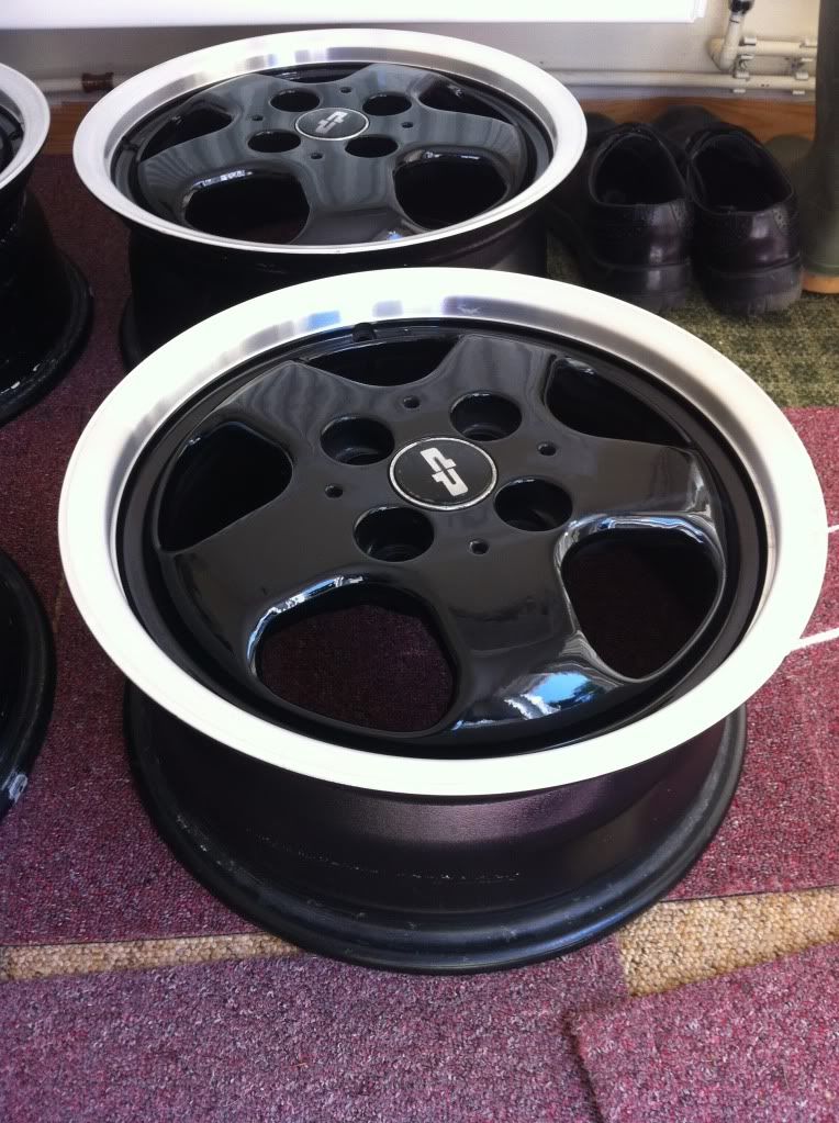

They are second hand wheels got from a bloke at stonor this weeken saying they came of a mk2 ,

They look like a flat seat to me, although I can see a taper I think this is just a lead in for the bolt.
I would take one down to a wheel shop and ask to be safe.
If you fit the wrong bolts to a wheel they come loose very quickly....

Ordered a 60' taper bolt today with 26mm thread m12x1.5 and fits perfectly so purchased a set of tuner bolts
Also found out on wheel whores that they are Porsche dp Motorsports wheels off a 964 possibly so may be worth something to the right person one day :)
