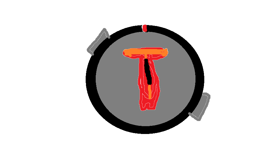

I thought he meant the crank was out. Trying to fire on cylinder 4 instead of 1. Anyway how can I change the dizzy 180. I know where the grove is on the distributor casing, has anyone got a photo (paint drawing) on how the dizzie should be set up?

This is the way round i have the rotor arm lined up. Is this incorrect? is this what should be 180 round the other way?
