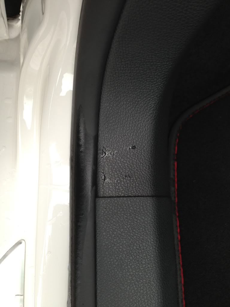

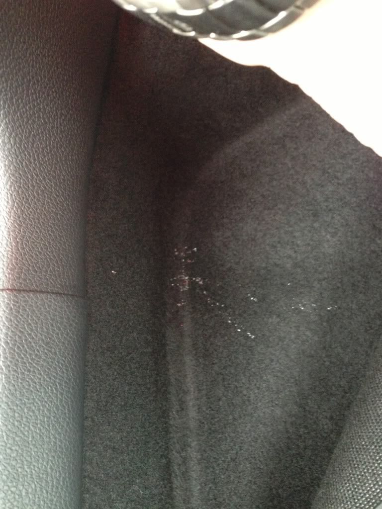

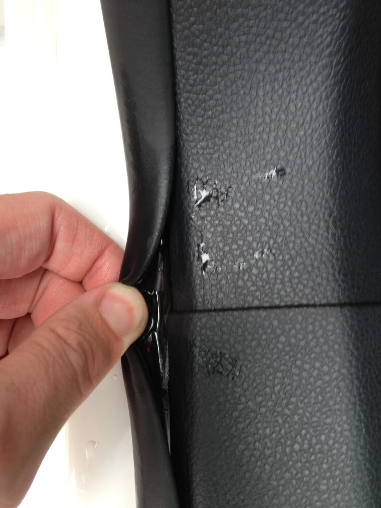

Anyone had this?
It doesn't look that bad but this was after I had driven home and the water had dried out a bit. The water runs in when I pulled out parking space, second day in the trot.

http://www.golfgtiforum.co.uk/index.php?topic=253623.0
I'm having an absolute nightmare with this at the minute. I'm awaiting a response from the garage today but they are getting nowhere, at the minute I don't think it's anything to do with their skills.
They are less than impressed with the build quality. I haven't seen any of it yet, but from what I can gather the inner door panel is held on with a combination of ally rivets and the plastic push in type so it can't really hold the inner panel up against the door with any conviction allowing the water to "piss" in.
I'll let you know what happens later, hopefully  :smiley:

Got my car back today. The parts replaced were outer door seal, the window regulator panel also the mounting adaptor for the speaker had cracked allowing water to pass through there as well.
I'll update as and when to see if it's sorted. To be honest if it isn't I've no idea what to do next.
