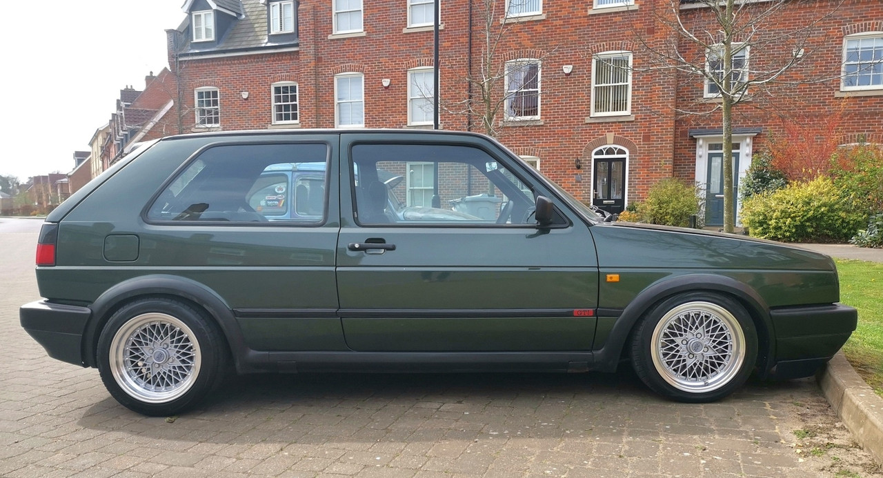

Ok so the story about this Calypso Green (LA6 Z) GTI! Was looking through the readers rides threads on here and saw that TK had picked it up after winning it on ebay, his plans were to start another project (had some awesome dubs), break it, or sell it. I was a bit gutted about the shell I had after finding the rust so sent him a PM straight away! He offered me to go have a look and if I liked it buy if off him. So the next day me, my old man and my good friend Adam headed down to have a look at it! He had told me that for the price I shouldn't expect a minter, it had been stood in a barn for 2 years but fired up and ran, needed the front end putting on etc. Anyway got down there after drooling over his mk1 with berg cup arches  8)  and his friends mk1 berg cup with a G60 I decided to buy the mk2 as it looked like a really solid shell. Paid the man the monies, rented a trailer the next morning and picked her up in the afternoon
So here she is when I got her home!
Totally fell in love with the colour as soon as I saw it! My plans are still the same to drop a 1.8T in but im going to get the car roadworhty and get it through an mot. Run it with the 8v GTI engine and do little bits now and then. My girlfriends dad used to own a body shop and mot staion, he has since sold the body shop and kept the mot station. He has offered to fill all the dints and respray the whole outside of the car if i pay for the paint, materials and help dig the footings for their new house. Good deal I reckon!

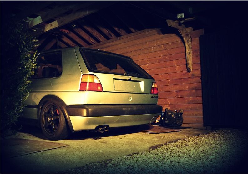

Just to keep the thread alive, few pics of tonights efforts, rear coillies greased and fitted, will be winding them all the way down
Also gave the G60 brakes a few coats of hammerite :)
Wound the rear coillies down all the way tonight! 8) These will be my winter wheels, cant remember what make they are but they are so light. Will need 4 new tyres as they are getting near the legal limit so will get some lower profile ones. I am also going to be rolling the arches as im looking to be running 8" alloys :D
Test fitted some different alloys tonight, 15" ... 7.5J ... ET15, hmm 8)
Ronal R15 Firehawks, (has made in W Germany stamped onto the back, not even there anymore is it? :lol: )
They will be getting resprayed and polished soon :D

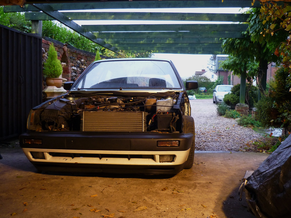

Spent most of today removing the engine and sub frame ... sounds pretty easy but with no engine hoist I had to get a bit inventive! :lol: Feels good to have actually made some progress towards getting the conversion started! :)
So this is how she stood this morning!
Then drove her into the garage for the last time with the 8v GTI engine pulling her!  :unsure:  Well she has covered 145k miles, deserves a new heart :wub:
Stripped the front end down, unplugged all the ancillaries, drained all the fluids and started to remove the engine mount bolts when one sheared off :blink: so this meant I had to change my plan of attack. Shot up to my girlfriend’s dad’s garage via McDonalds, stopped for a light lunch and picked up an M12 spline to get the cylinder head bolts out. Got home removed the cylinder head bolts and unbolted the downpipe from the exhaust (was going to remove it near the manifold but I’m sure VW purposely had fun designing it so its awkward as F**K to work on  <_<) Then I managed to pull the cylinder head up and out  :D
I then unbolted the rest and got the bottom end out like this  :lol:

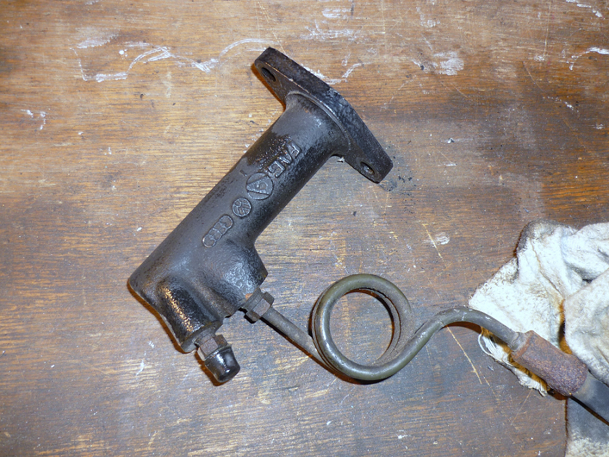

My O2a box is pretty dirty but gave part of it a clean up to see, if I can get the rest looking like this I’ll be happy  B)
