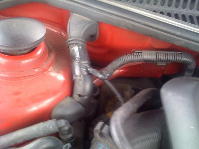

the looms break in the little rubber grommets that clip in to the brackets on the shock, you can't check it visually. If you wanted to be 100% then you have to get the abs module plug off and start checking continuity. 1 person watching the multimeter and one twisting the wires.

The top of the shock is where it looks like the abs wires come into the engine bay and looks like a botch up done before as it is full of masking tape?
