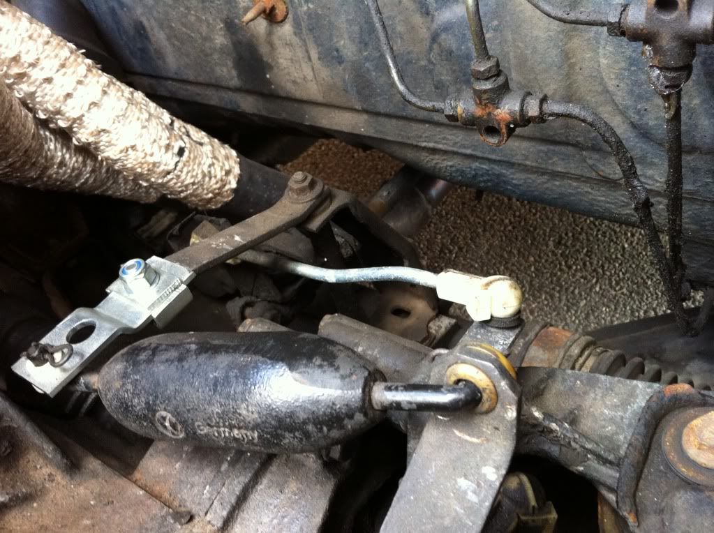

1. Get a manual cable. Also, check for the short shift, and if it was me id remove it. you can see it in this link
http://i284.photobucket.com/albums/ll11/notchnut/My%20Golf/4deae84c.jpg
also, if you dont have weighted shift rod, the one in the pic with the big lump of metal around it, go but one. they cost £11 from VAG

1. Get a manual cable. [This does seem to be the consensus, why is it better?] Also, check for the short shift, and if it was me id remove it. [I don't really mind the short throw, it is just the dodgy changes I'm unhappy with, so I may remove it after I have sorted all other potential problems] you can see it in this link
also, if you dont have weighted shift rod, the one in the pic with the big lump of metal around it, go but one. they cost £11 from VAG [Yep, I'll get one. Sounds good.]

You can buy short shift kits. They just extend one of the linkages which gives you a shorter gear change throw. Check the linkages for any add-on's. Should just be thin rods or one with a weight on it (mk3)
