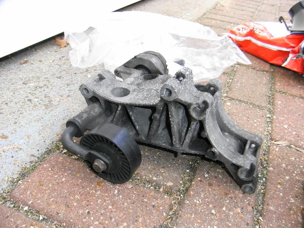

The 1.8 alt with the built in tensioner can be straight swapped with a bracket from a model with air conditioning and then any VAG alternator can be put on it (re the bolt pattern). You will need the bracket - http://i1017.photobucket.com/albums/af293/Daniel_Brill-Edwards/My%20Golf%20Mk3%20Build/RIMG0054-6_zps675a5d9c.jpg

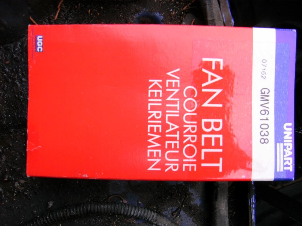

Alternator, the 2 bolts to mount the alt to the bracket and a different length belt I tried a couple and found the best is 1038mm - http://i1017.photobucket.com/albums/af293/Daniel_Brill-Edwards/My%20Golf%20Mk3%20Build/RIMG0064-5_zps734ff750.jpg
