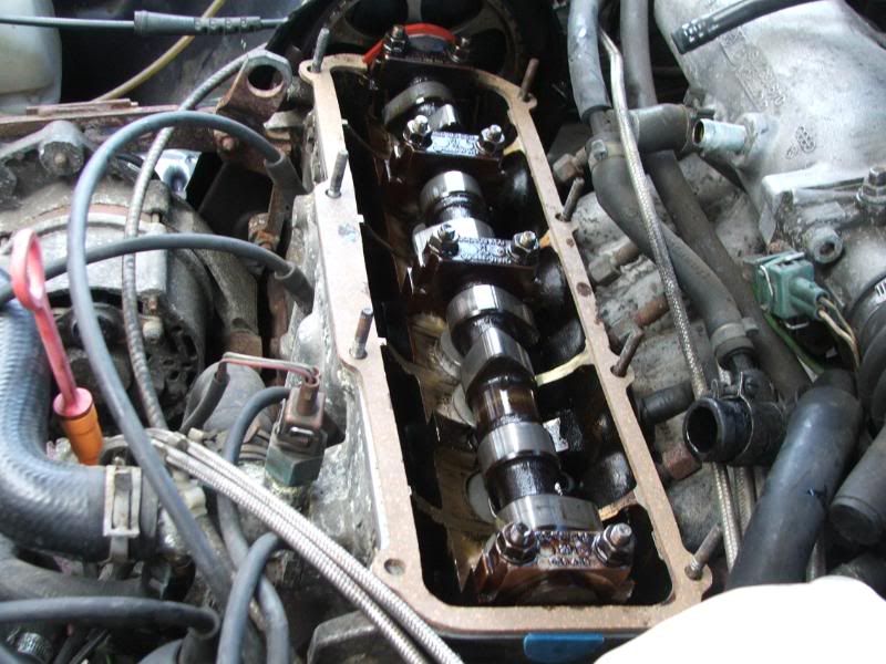

Need some help with this one guys, I'm in the middle of refitting my cyclinder head following having it skimmed, and I seem to have mixed up the order of the cam caps
I'm fine with the first one as it's the different shape, theres some funny markings on the top of the caps which seem to read 2, 3 & 5
Can anyone tell me how to correctly identify the cam caps and put them in the correct order?
PLEASE!!!

this help you? there is no number 4 cap
taken from here:-
http://www.clubgti.com/showthread.php?207391-8v-Head-differences
